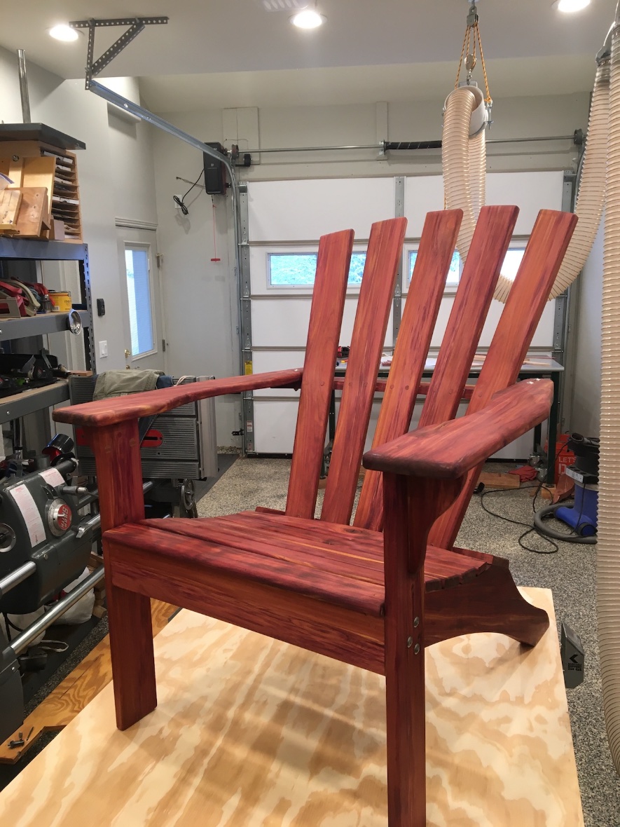

I recently purchased a set of Fuller countersinks that I really like. It's a set of three for #6, #8 and #10 screws https://www.amazon.com/gp/product/B003N ... UTF8&psc=1. The set also comes with a plug cutter that worked really well too. I used the #8 earlier this month on a pair of Adirondack chairs to countersink and plug all the screws and it worked beautifully.
