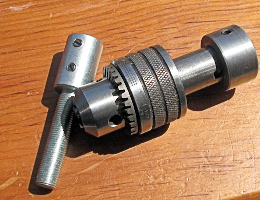

If your chuck is the usual one supplied, it has a 5/8" hole in it and just slides on the 10ER shaft and is held on by the set screw. There is no "adapter".

I have also seen non Shopsmith chucks screwed on an adapter like on the left in this pic:
[ATTACH]22051[/ATTACH]
Once the setscrew(s) removed you can put penetrating oil in the hole and both types should come off eventually if rusted in place.

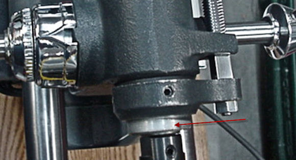

By the way, (re the "adapter above the drill chuck") if you are looking at the ring pointed at by the red arrow in this photo:
[ATTACH]22052[/ATTACH]
It is not an adapter or part of the chuck. It retains the spindle bearings and is not removed.
