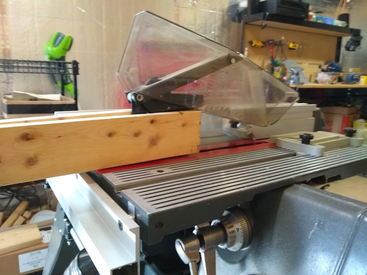

Thank you all - I went down before my coffee to test out the suggestions.
Lowering the main table until it kissed the top of the Powerpro did the trick. It gave me about 1/8 to 1/4 more clearance and the board progressed through.
I think the kickback pawls (thanks for the vocab!) were stopping the forward motion while pushing on the board, as someone adroitly noticed-they were all the way up riding in their slots.
I did get some slight burning on about 25% of the face, so i think next time I will try a 2 pass covered approach. It did get a little awkward once the board was fully under the plastic shield and trying to push through the narrow gap with the push stick.
As I run the saw with the quill pulled back, the main table interferes with the top of the powerpro, but I was wondering, is it OK to extend the quill out 3 or 4" to allow the table to come down further, or should the table saw only be run with the quill near fully retracted?

Some times the upper saw guard is more of a problem than it is a solution. IMO you just experienced that. To avoid that situation, I would have either flipped the upper saw guard up or run the cut without the upper saw guard. If running without the saw guard I highly recommend using the Shopsmith Riving Knife in place of the saw guard.bainin wrote:Thank you all - I went down before my coffee to test out the suggestions.

I have never used the table saw with the quill extended more than an inch or so (for bevel cuts) but the idea of extending it to facilitate lowering the table further is a scary thought. I don't think it would be safe. Don't ask me why. I am just uncomfortable with the thought.dusty wrote:Some times the upper saw guard is more of a problem than it is a solution. IMO you just experienced that. To avoid that situation, I would have either flipped the upper saw guard up or run thew cut without the upper saw guard. If running without the saw guard I highly recommend using the Shopsmith Riving Knife in place of the saw guard.bainin wrote:Thank you all - I went down before my coffee to test out the suggestions.

I do not find the thought of extending the quill for sawing scary, but, think extra caution is prudent.
Making sure the blade does not reach a position where it interferes with other stuff under the table, or the table insert.
No I have not tried it. Not sure there is sufficient quill range to clear the table from the top of the headstock(not able to go to shop to verify).
