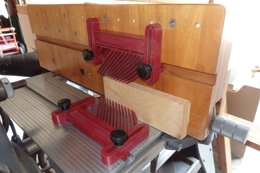

In br549's post he referenced the main table with the second blade slot
If you choose to make a table addition by covering the main table with a larger wood top you will lose cutting capacity equal to the thickness of the wood. In most cases this would not be a problem. You will also reduce where you can position the fence with a cover top in place. Before making changes try cutting some panels to width. Remember the Mark 5 (pre 1980) or Mark V with the original table system aka 500 has a 48" capacity. Just make sure you have any help you need to feed and hold the out-feed when cutting to do it safely. You may find that you can do cuts without additional tables. If you need to cut stock longer than 48", while using the fence, than an upgrade to the 510 or 520 Table/Fence system may be for you.
