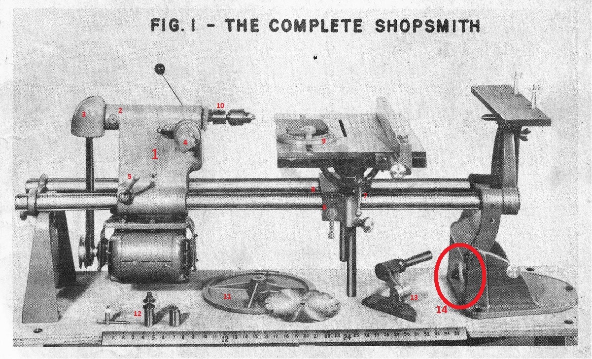

I have talked a lot about the Shopsmith Model 10E and 10ER to this point. I thought it might be nice to gather references for them in one spot.
At this point in time, I know of 14 different manuals that were released for the Model 10E and 10ER. Most of the need for newer versions of the manual were because of changes to parts requiring updating the drawings and parts lists. The actual operation did not change a lot. Probably the biggest change in the operation was going from the wooden extension table to the metal one. In the Maintenance and Repair section under the topic Shopsmith Large Format Drawings, Illustrations and More by Everett Davis which is one of the first threads is a link to Everett’s Google Drive where under 10E & 10ER Magna you can find restored PDF versions of the original typed Preliminary Model 10E Manual, a Model 10E Owner’s Guide which has the wood extension table and a Model 10ER Owner’s Guide from 1952. All three include additional information not found in the original printing of the manuals.
Choose the manual that is closest to your Model 10E or 10ER for use if you don’t have one already. There is a lot of other great information to be found there on Everett’s Google Drive. If you are looking to replace the bearings for the Quill or the Drive Sleeve look at the information under the heading Bearings. The Book Power Tool Woodworking for Everyone by R. J. DeCristoforo was written about using the Shopsmith and goes more in depth than any of the manuals. Under the heading PTWFE 10ER 1953 is a Revised Digital PDF version of the 1st edition of the book. The 1st edition is based on using the Shopsmith Model 10ER and is a great reference book on how to do more with it. Later editions show the Mark 5/V in use. Again, a big thank you to Everett for the time he has given to restore these documents for our use.
There has been additional information gathered throughout the years which change or add to the information found in the manuals. The PDF below is a recommended change to the original manuals for maintenance of the Model 10E and 10ER and a good addition to your Model 10 manual. It is one that I created.

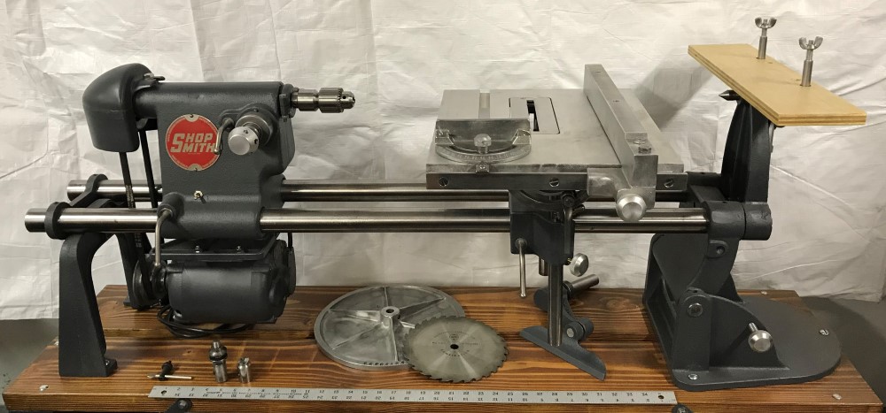

Hoping you guys can help a fella out. I just got this Shopsmith and it was given to me so the price was right (I hope). Now I need info on it. I've never had one and never really been around one. Have been searching the internet but there is a lot to go through. I'm guessing this is a 10ER, with serial #R47353? I want to fix it up to use, not going to be a show piece. Can you all tell me what I have for sure and if I need to know anything in particular about it.
- 275101438_1137221780158613_1240317432613704674_n.jpg (228.89 KiB) Viewed 59507 times
- 274982712_5241200905962347_6507970277081046218_n.jpg (205.83 KiB) Viewed 59507 times
- 274972428_1143635126397656_8212147138244995334_n.jpg (362.01 KiB) Viewed 59507 times
~~Blain~~

whiteb01,
First welcome to the Shopsmith Forum. Your Shopsmith Model 10ER (even though it says ER) was made in later 1950 in the Western Plant as indicated by the R of the serial number prefix.
Something I noticed in the picture of the entire unit is the Headstock's Way Tube Lock is missing. That may explain why there are hose clamps on the Way Tubes between the Headstock and the Carriage. Since I cannot see all of the Quill Return Spring Housing I cannot tell if you have Headstock version 4 or 5. It changed around the time your Model 10ER was made. Either way the missing lock for the Headstock would be the double wedge type. The picture below shows the three locks used on an early Model 10E and are similar to the ones used on the early 10ER. The top one is the Quill Lock and the middle and bottom locks are for the Headstock Way Tube Lock and the Carriage Way Tube Lock which are the same. The ones shown in the picture below are the very early brass wedges which was soon changed to wedges made out of an alloy. The later single wedge locks will not work in your Model 10ER.
_ .
Note in the picture above the lever of the Quill Lock is different than the ones for the Headstock and Carriage. The Quill Lock in your Headstock is keyed which was used only in the version 4 and 5 Headstocks. As with the locks being double vs single wedges some parts are not interchangeable on their own. Some things would have to be changed as an assembly. Since your Shopsmith is over 70 years old replacement parts have to be found on the used market. Generally used replacement parts are not hard to find.
As David noted you have the Speed Changer with it that looks to be complete. They are a nice addition to the Model 10's but do be careful as they can be easily broken with incorrect use. Never try to adjust the speed past the point the springs on the rear of the screw assembly begin to compress. The speed will not go any higher or lower but you can brake the unit.
Some rust removal, cleaning up and paint if desired and you will have a great woodworking machine. One of the things I like about these Shopsmiths is with a little care they can seemingly run forever. I encourage you to start your own thread to ask questions and share information about your Shopsmith Model 10ER as you get it up and running. That will keep your information specific to your Shopsmith in one place.

So what you're saying is that the hose clamps aren't original? Joking of course.chapmanruss wrote: Sun Mar 06, 2022 2:48 pm whiteb01,
_
I really appreciate you're info, you told me a lot that I didn't know. I will take your advice and start a new thread.
