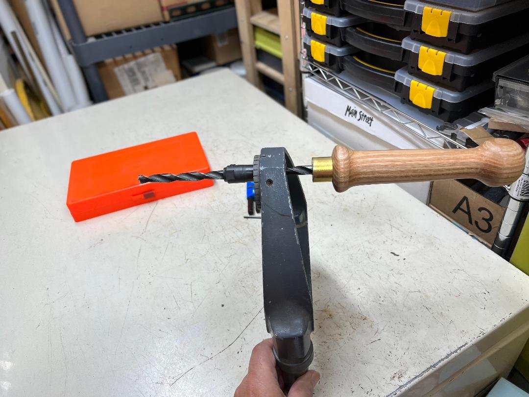

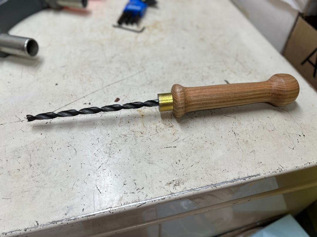

We are going to take a slight change of direction for a moment. I think I posted this home made drill tool here somewhere but it was a while ago.
This bit is also 3/8" and it too works with the dead center as shown here:
If you think an auger bit fills up with swarf fast you haven's seen anything yet..... these bits also compact the materials too!

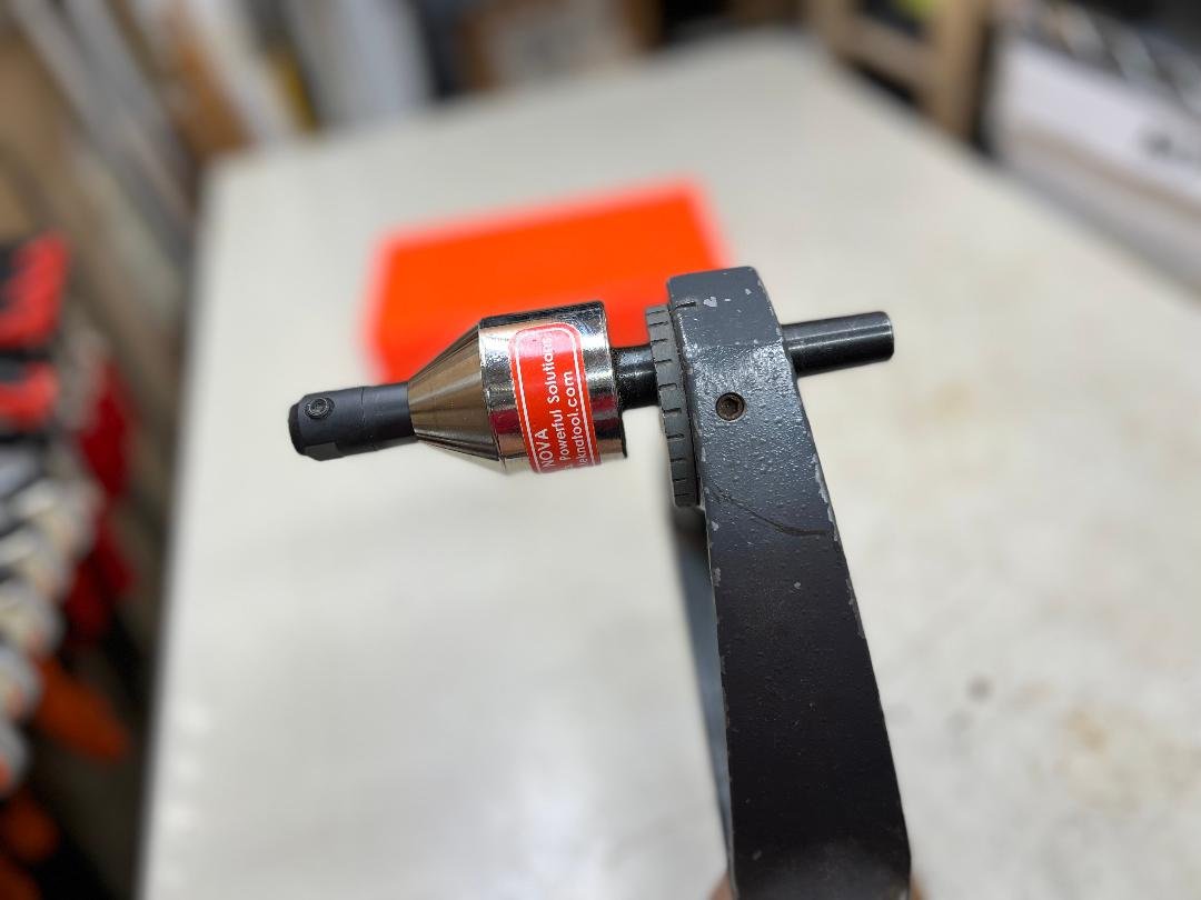

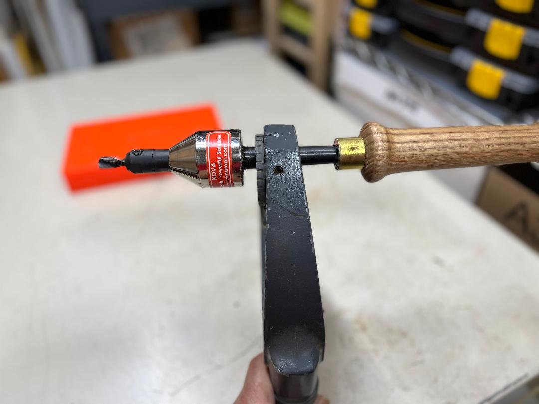

Now back to the other information I wanted to share. If you have the Nova live center you can use the shown dead center and end up with a live center that can take a 3/8" bit.
If you have the Oneway live center I think that is limited to 5/16" but I have not gone back to make sure of that......

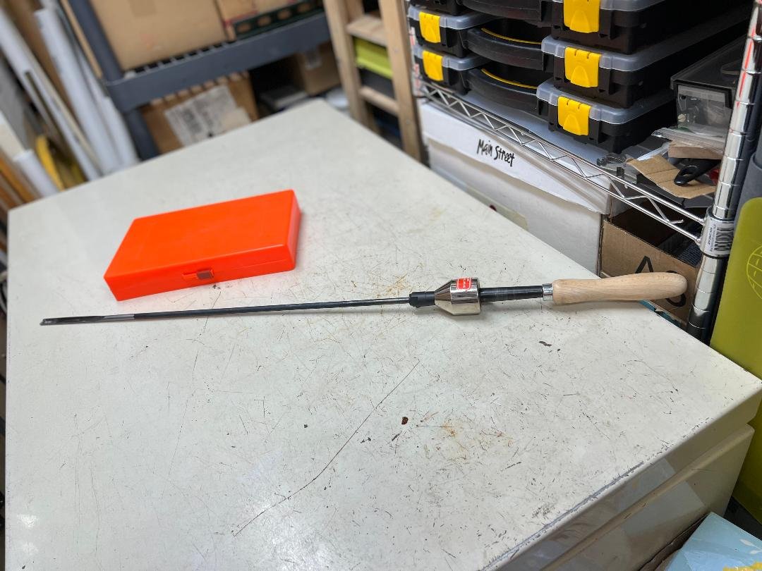

Of course if you have one of these live centers it eats up a lot of the drill bit as seen here:
The lamp auger of course gives you a lot more bit.
