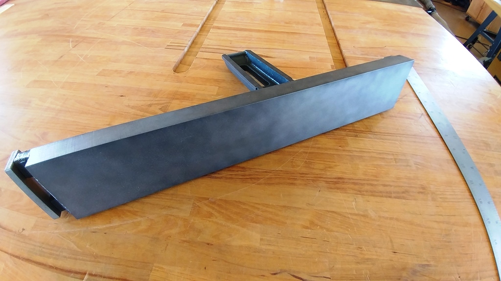

Very nice dissertation. Do you have any idea when the cast iron extension table was made? I would think it was the first metal extension table made when they went away from the wood table. Then they very quickly went with aluminum like the main table. That would explain how rare they are.

Your guess on that is as good as mine. Your picture is only the second time I have seen a picture of one. The other was one for sale on eBay. It being made at the change from the wood to the metal Extension Table does sound the most reasonable. But cast iron instead of aluminum like the Main Table makes me wonder why would they even try a cast iron one.

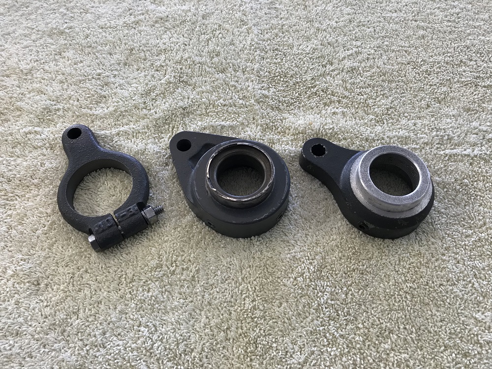

When they changed from the original clamp on Quill Collar the first ones were cast iron followed by the aluminum ones used for the rest of the Model 10's production. In the picture below is the cast iron one in the middle. Maybe cast iron was easier to try things out with first.

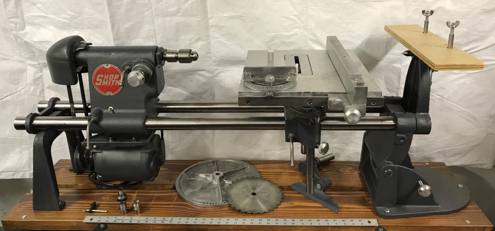

The picture below is a recreation of Fig. 1 and it shows how the first Model 10E's came from the factory with one slight exception.
We will discuss that exception later but in the mean time see if you can guess what it is.

My guess is the type of wood used for the extension table and that really is a guess.
