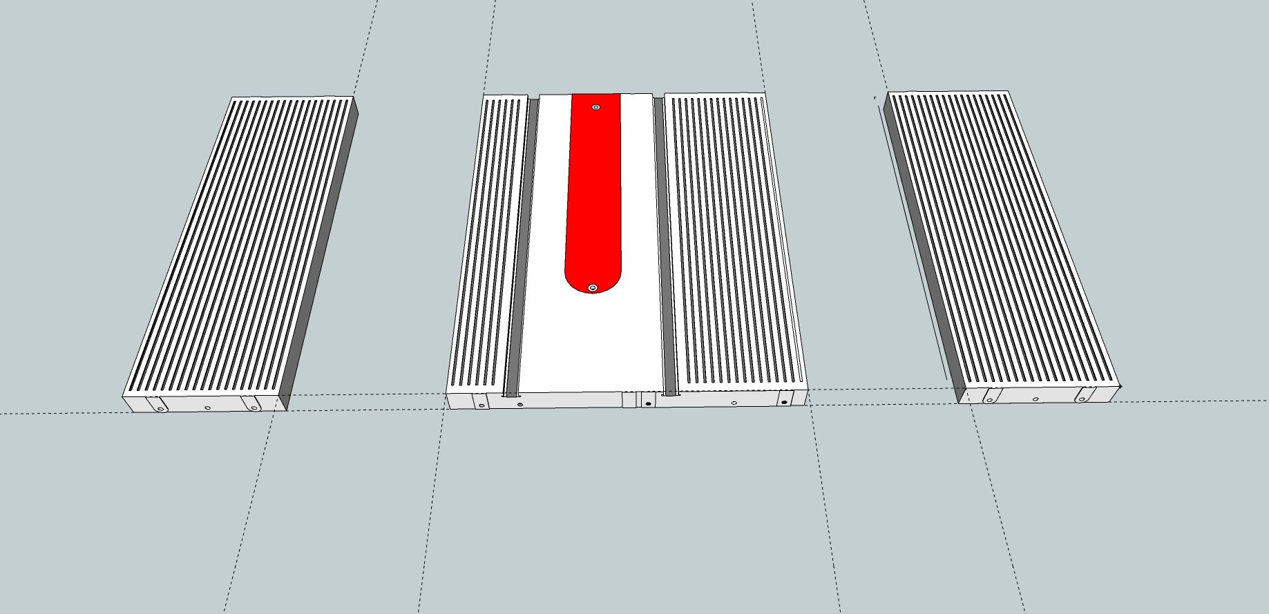

Parallel Extension Tables
Posts: 21368
IF a=b and b=c then a=c
If two lines are both parallel to a third line, then they are also parallel to each other.
If two Shopsmith tables (Main Table and Right Extension Table) are both parallel to another extension (Left Extension Table) then the Extension Tables are parallel to one another.table. There seems to be some disagreement. What say you?????
We have discussed, many times, the difficulties that some have getting the two extension tables parallel to another.
What is wrong with this logic???? Why is it difficult to achieve extension tables that can be exchanged????
Two Sets of Extension Table Legs.jpg (54.4 KiB) Viewed 1293 times
algale
Posts: 4795
Re: Parallel Extension Tables
Post by algale »
Presumably because the table tops are mounted on tubular legs that pass through bore holes in the castings and additional bore holes in the castings hold the way tubes and bench tubes. You've got three axis of potential lack of parallelism: (1) front to back (imagine a horizontal line passing through the center of the leg bore holes in the end castings and the carriage), (2) vertically through the leg bore holes and (3) side to side through the way tube bores and bench tube bores.
If any of the bores don't align perfectly both horizontal and vertically, you'll never achieve interchangeability. Yes, all three table tops can be adjusted to be parallel to one another in a given configuration because they tops of the table can be adjusted independently of the tubular legs. But when you go to swap left for right extension table, any small lack of parallelism is revealed.
I doubt the tolerances of the bores in the castings are held tight enough to allow such interchangeability except by dumb luck. I also figure the way tubes and bench tubes have variations that contribute to the issue.
I don't think I've said anything here that will add anything new to your understanding of the Shopsmith or what others have said in the past about this issue.

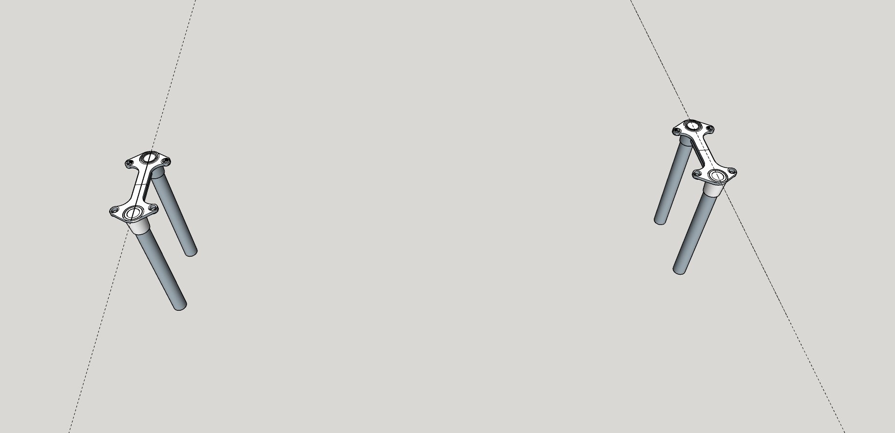

Posts: 21368
It seems to me that all three of your hypotheses have been covered.
Extension Table Ideal Setup.jpg (212.81 KiB) Viewed 1281 times
Keep in mind that the Main Table provides the reference surfaces Left, right, up, down). The tables (extension) can be aligned independent of the Bench and Way Tubes.
I am not arguing a point! I am trying to understand a phenomena that 'seems' to exist.
Posts: 34631
Understanding comes from accepting what Algale just said.
Anything that an extension table attaches(directly or indirectly) to will cause the thing that exists.
Each table can be individually adjusted to be parallel with the main table. Those adjustments compensate for the unique variation from perfectly nominal that the spt mounts exhibit.
Now the left and right spt mount anomalies will extremely unlikely be unequal.
So swapping the tables is unlikely to be equivalent.
Now I for one think by adjusting the bench/way tubes/spt mounts(end castings) one can get close to achieving what you describe with one table so with two the same result could occur.
However close is not good enough for those of us persnickety folks that worry about such things.
Posts: 21368
JPG wrote: Tue Dec 08, 2020 8:18 am Understanding comes from accepting what Algale just said.
I am not certain whether you agree or disagree but I believe the objective is achievable by anyone who is persnickety enough to pursue it.
Posts: 34631
Agree? Yes and no.
I believe on can achieve parallel to the blade easily enough by compensating for parts variations. Any thing beyond that will be affected by the floor and legs in addition to parts variations in the other two planes.
