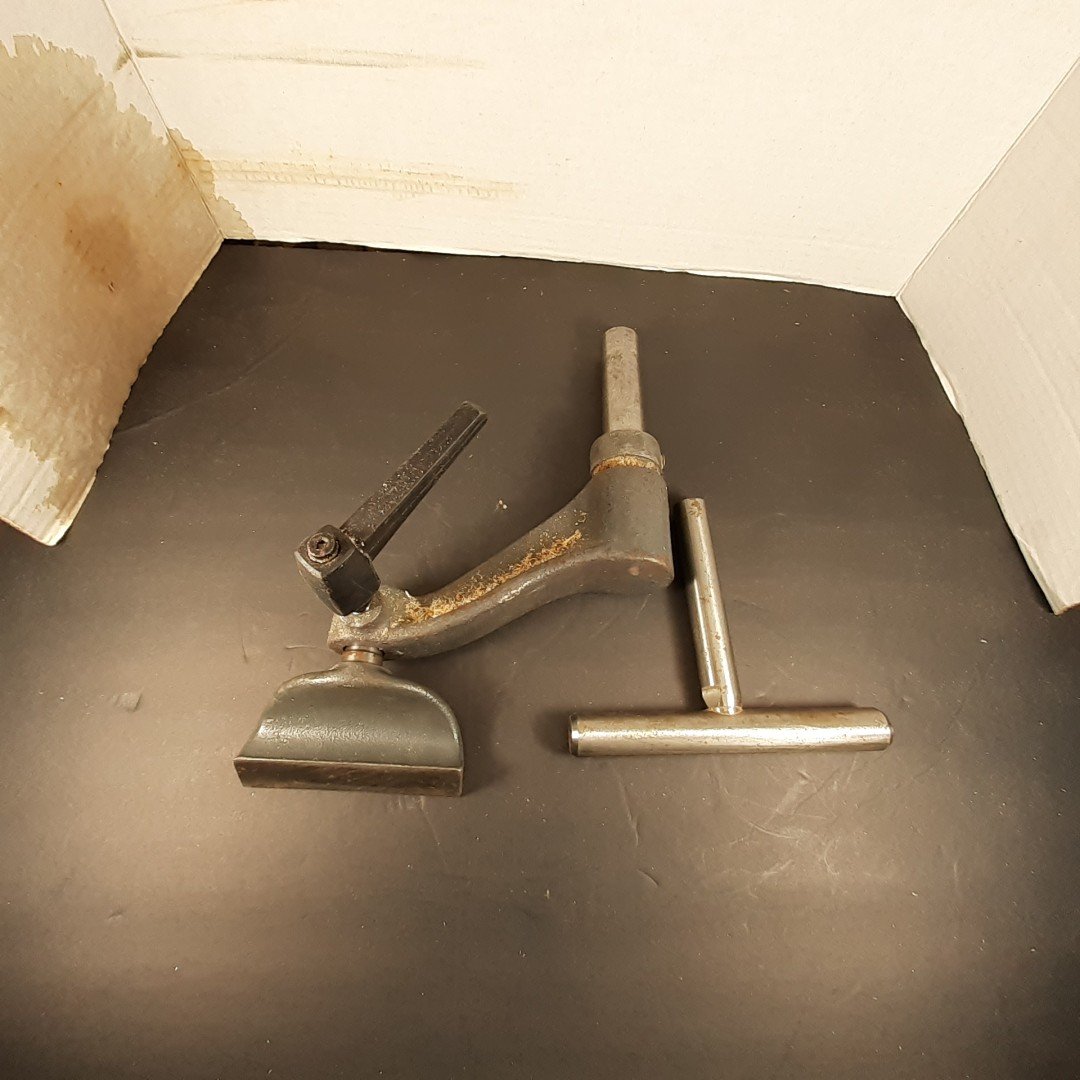

The 10E/ER tool rest arms are different than the Mark V arms, but the tool rests themselves both have 3/4" posts and will work fine.
I have a SS 4" tool rest that I got on eBay and also have a modular rest that I got from Lee Valley with a 3/4" post and they both fit.
tool rests.jpg (142.91 KiB) Viewed 526 times
