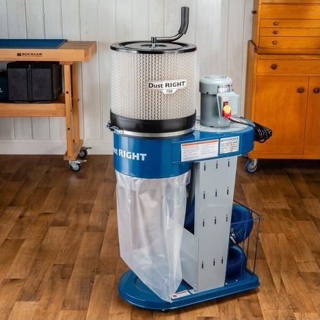

I'm not interested in buying either one but since shopsmith has introduced this I have taken the time to check out what little they have given as specs for it. Then last night I was looking at my freshly delivered Rockler catalog and noticed they have a similar at least in some respects system.
Shopsmith $739 +??
Rockler $550 + Additional Shipping and Handling Charge: $35
Shopsmith 8 AMP 1-1/2 HP
Rockler 12 AMP 1 HP
Shopsmith 600 CFM
Rockler 750 CFM
Shopsmith 21"w x 26"d x 48"h
Rockler 16-1/2''W x 30''D x 54-1/2''H
Shopsmith 7 microns - only 1 micron with optional 42" Hood
Rockler Filter Type: Canister 1 micron
Shopsmith 64 pounds
Rockler 88 pounds
Shopsmith Power Cord 12 feet
Rockler Power Cord 10 feet
Shopsmith 74 decibels
Rockler 75 dB
Shopsmith hose 12 foot
Rockler no hose
Shopsmith Bag Capacity 30-gallon
Rockler Bag Capacity: 11 gallons (about 1-1/2 cubic feet)

Yeah, I saw this one recently too. Assuming the pic below is the one you are referring to. It looks interesting. I like that it is rather compact, but this could be a negative. It is very short which could be an advantage if you someone needs to tuck this in under a cabinet/shelf on a wall. That bag is small at only 11 gallons versus 30 gallons on the DC-3300/6000. Also, wish there was an option for a taller filter cartridge, or one that goes down to 0.3µm. Looking at the online reviews for it, they appeared mixed. I mean some complain about the X brace catching wood chips/shavings and blocking the inlet. Others complain that the small filter cartridge clogs quickly and has to be cleaned daily. Still, it is always nice to have more choices available in the marketplace...

Is the smaller bag really a negative. How often does that thirty gallon bag get filled? I almost always change bags long before it gets half full.RFGuy wrote: ↑Tue Jan 26, 2021 8:29 am Yeah, I saw this one recently too. Assuming the pic below is the one you are referring to. It looks interesting. I like that it is rather compact, but this could be a negative. It is very short which could be an advantage if you someone needs to tuck this in under a cabinet/shelf on a wall. That bag is small at only 11 gallons versus 30 gallons on the DC-3300/6000. Also, wish there was an option for a taller filter cartridge, or one that goes down to 0.3µm. Looking at the online reviews for it, they appeared mixed. I mean some complain about the X brace catching wood chips/shavings and blocking the inlet. Others complain that the small filter cartridge clogs quickly and has to be cleaned daily. Still, it is always nice to have more choices available in the marketplace...
I change bags. I do not reuse one once it has been used.
If I didn't have a dust collector this one would be under consideration.
Re: Rockler dust right 750 CFM and Shopsmith DC-6000
Dusty,dusty wrote: ↑Tue Jan 26, 2021 8:54 am Is the smaller bag really a negative. How often does that thirty gallon bag get filled? I almost always change bags long before it gets half full.
Good point. Yeah, I typically never let my Shopsmith 30 gallon bags get full because they can be a real bear to change when full. The Rockler 11 gallon bags are more narrow and taller so my guess is it would be easier to fill these near capacity before swapping out. Definitely could be an advantage having a smaller bag depending on the shop.
