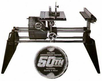

In 1985 the Mark V 510 and 505 were introduced with the larger table system that included floating tables for the 510. It was at this time that the Mark V with the original table system became the Mark V 500. A special note about the Mark V 510 and 505 is during their first year in production the fence tubes were slightly different and mounted different than later Mark V 510 and 505 tools. You can tell the difference between the early Mark V 510/505 by the holes on the fence tubes they had compared to the later ones without the mounting holes. Below is a picture of a Mark V 505 and 510.
Mark V Model 505 50th Anniversary.jpg (17.73 KiB) Viewed 3685 times

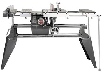

In 1999 the Mark V 520 was introduced with the Pro Fence. It uses the same tables and carriage as the Mark V 510/505 but has extruded aluminum fence rails and a larger fence. It is the same table system used for the Mark 7 which came out in 2010. Below is a picture of a Mark V 520.
_
Mark V Model 520.jpg (12.21 KiB) Viewed 3685 times
