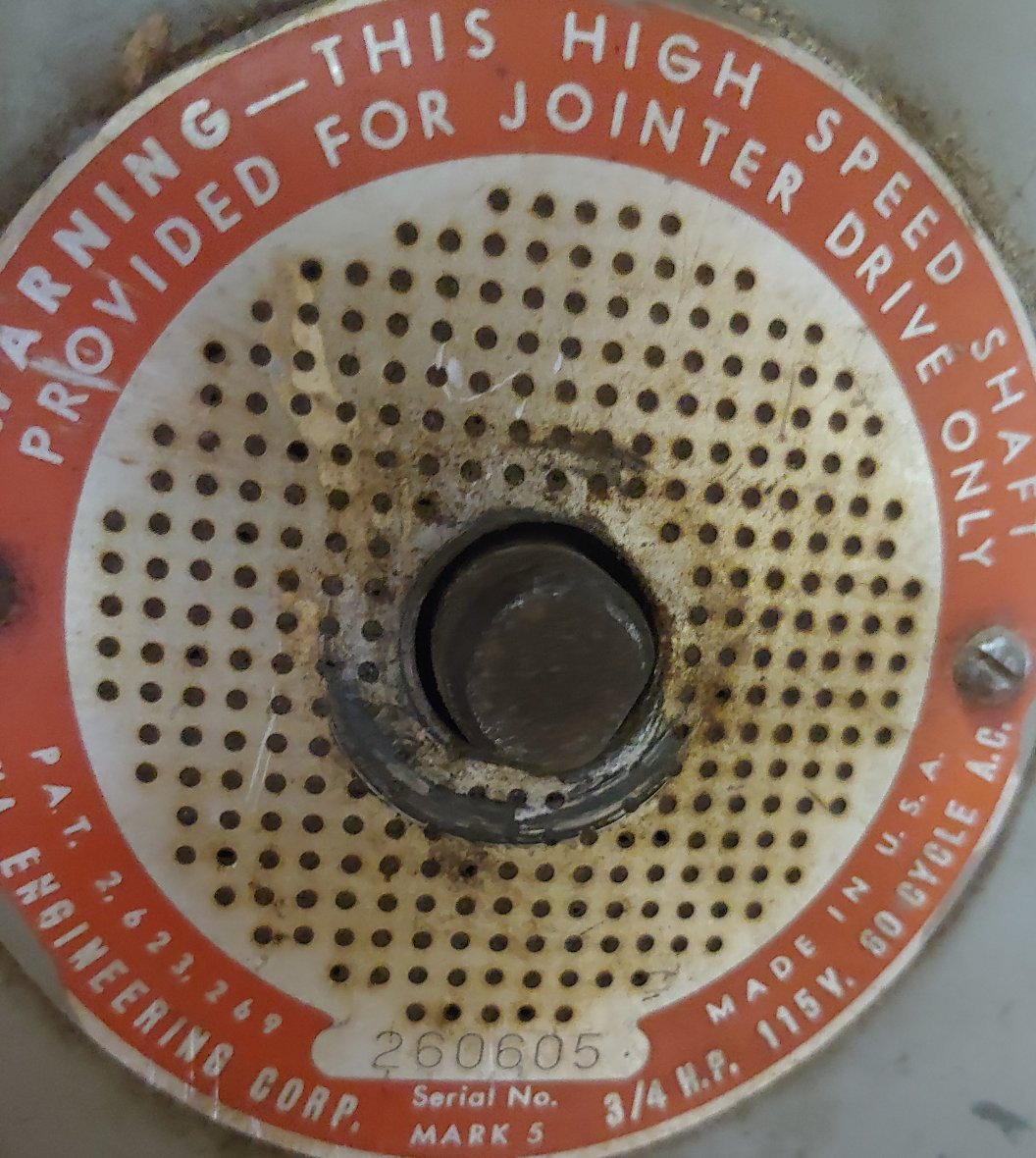

Re: Shopsmith Mark 5 What When and Where
I have a "Mark 5" with serial number 260605.
I inherited it pretty well unassembled. Some of the aluminum/white metal parts are broken, but the powerhead works. There is a planer/joiner, and sanding disk. 2 of the rails are pretty clean, 2 others have a bit of a rough 'patina'. I do not know if I should invest in getting it fixed up, or sell it for the parts that are good. I am looking for suggestions, and happy to provide any info to others doing investigations.
- 20201026_154637.jpg (217.15 KiB) Viewed 3599 times
