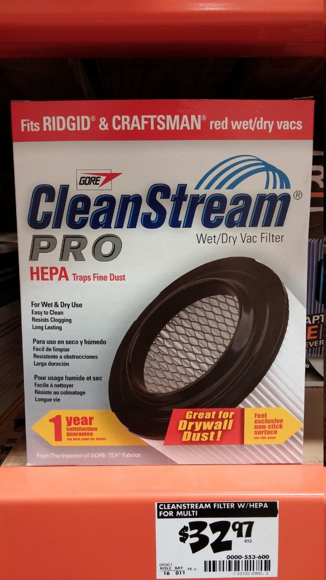

I have been using a Clean Stream Filter in my shop vacuum for several years. I would never go back to the old disposable filters. It makes a massive difference for sanding.
