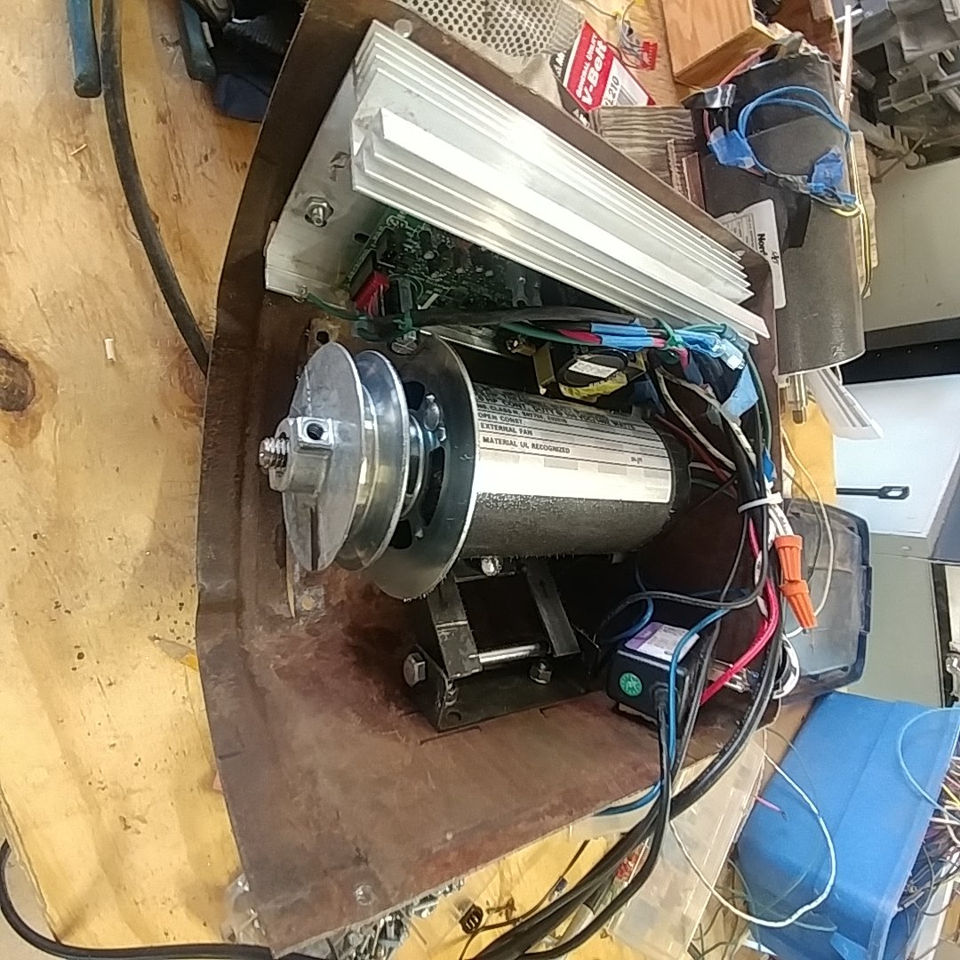

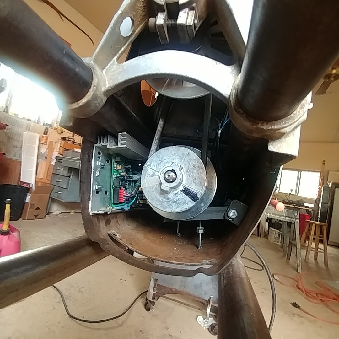

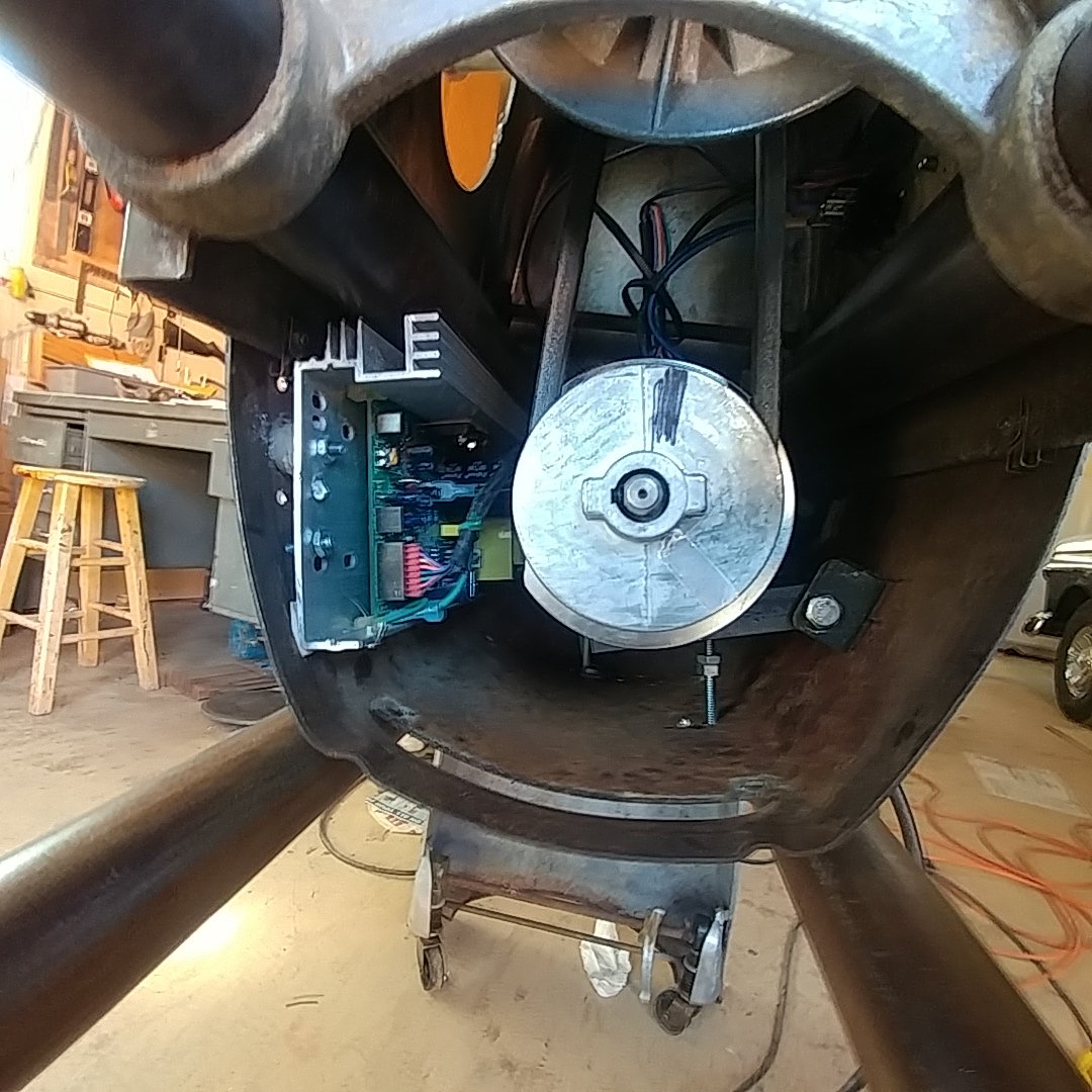

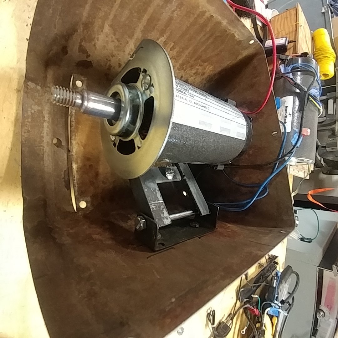

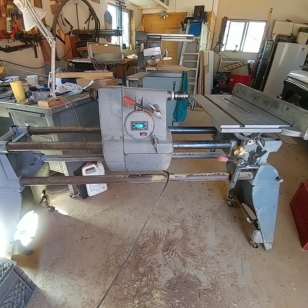

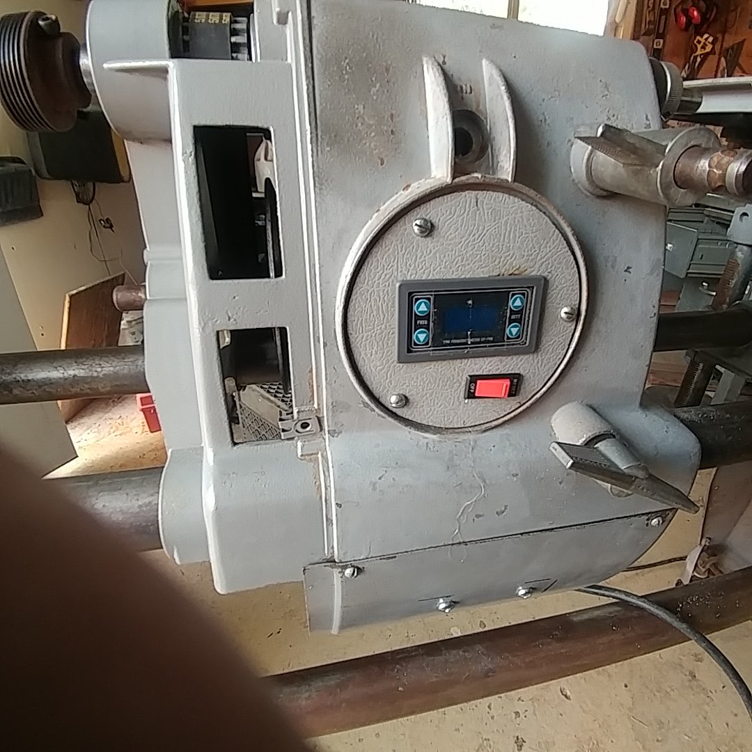

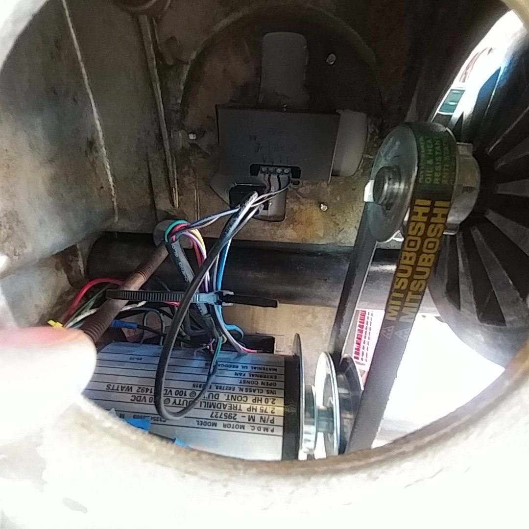

I recently finished (for now) my conversion of an old SS MKV to a DC treadmill motor.
The motor is a 2 HP continuous duty @ 100v. The controller is an MC2100 PWM (pulse width modulation) variety. These appear to be the most robust. Speed is controlled by a small digital PWM controller feeding the speed signal (in %) to the 2100 controller, then to the motor.
I have a V belt from the motor with a 3.5" pulley to the idler shaft with a 1.75" pulley, then a std. gilmer belt to the main shaft.
Speed is starting at 15% (275 RPM) , up to 65% (4100 RPM) . This is as hi as I have taken it so far. I should have usable power up to about 85%.
Some people hear have wondered (including me) how powerful and robust this kind of conversion would be. This is what I've found so far.
I've ripped several 2x6s; 4 and 8 foot without any problems using my old but resharpened combo blade running at 55% (3300 RPM).
Then I tried drilling a 1/4" hole thru steel at 15% (275RPM). This didn't work. Speed would wander; slow and stop. I had to take it up to 20% (525 RPM) to get it to maintain the speed and torque. This is faster than I wanted.
So for me it was mostly a success but room for improvement. I can try different pulley combinations to get more low speed power; add a fan, a reverse switch. etc. but I will work with it as is for now.
This is not going to replace a Powerpro but is still a useful tool especially when you can get lower than 700RPM to work with steel and I rarely go above 4000 RPM.

Cool! I can see it would be tough running at 15% power even with a PWM controller. Maybe a flywheel would help a little but I think you need to make adjustments to the pulleys get the kind of slow speeds for metal working. Of course there is always the speed reducer to use also, but getting those slower speeds should be an advantage of the DC motor.
What I want to do soon if I can get make some progress on a backlog of projects is use a DC motor to drive my Delta bandsaw. I wanted to use a regular Shopsmith head somehow but it's been problematic so far and a DC motor I already have should do the job fine, although I will need a rather large secondary pulley to get the speed down. I could use a grooved multi-V type pulley that would match the grooved pulley on the motor I have but I'm going to try using a flat belt and flat secondary pulley instead. If the grooves in the primary pulley are a problem they can be filled with something. I will use the same kind of pulse generator and MC2100 controller as you have done. Glad you worked that all out for me in advance!
I assume your motor has some kind of internal fan but for low speed operation I think you need to add a separately powered fan to keep all that hardware cool. Looks like you may have room under the belt cover for that and you could move the nameplate somewhere else (maybe to the right side of the headstock instead of the left) and have a small fan and filter provide positive airflow into the head. That will be even more important when you create metal chips and dust instead of the wooden variety.
Great work so far, looks really nicely done with the interface and all. Quite impressive and I think a lot of us want to hear more about how it performs.

I wanted to use multi groove belt and pulleys couldn't find a lot of options there so I went with V belt. I'm not too happy with the pulleys. They don't appear to be concentric with the ID. When running slow I could see the pulley going up and down as it turned probably .015- .020".
You have a good point about heat. I'll probably attach a thermocouple wire to the motor case and monitor it . If I need to I can add a 12v PC fan to the inspection hole on the back of the headstock and pull air thru the opening on the botton cover.
