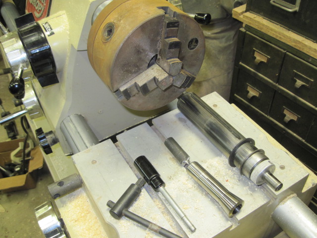

Here are a couple of photos of the machine I have, which the previous owner said was about 10 years old. Don't know if there have been any changes since this one was made or if the Harbor Freight model is identical to the Smithy, but they're all based on the Fox machine of some 30 years back.
I've finished aligning everything, but not tried it out yet. Hope to do that over this weekend. The lift assist spring has been tensioned and it's now harder to lower than lift, but it was quite a chore getting it there so I'll leave it as is for the time being.
Smithy doesn't have many accessories for the machine, so I've fashioned a spindle out of 5/8" drill rod with a tapered flat that will fit a 5/8" R8 collet and will allow me to mount Shopsmith accessories of the SuperShop.
In the first photo, you can see the size of the spindle on the SuperShop.
The second photo shows the pulley and belt system. You have to shift the belt in order to cover the entire speed range of the machine. The speeds for the three sets of pulleys are 32-900, 1200-3600, and 4000-7200 RPM. A couple of levers allow you to move the lower pulleys, so it's a simple process to change speed ranges. The motor is variable speed, 1.5 HP, 90 volt DC, 2,800 RPM.
The Third photo shows the 6" metal chuck mounted to the spindle, together with a chuck key, tommy bar, lathe drive center, R8 collet, and Shopsmith spindle/quill assembly.
