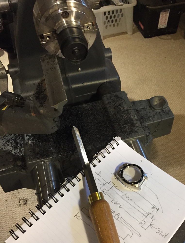

Here is some 1.5" acetal chucked into my 4-jaw:

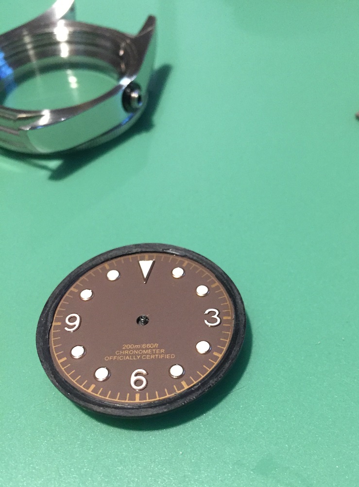

Here is the rough outcome, which was not bad; I did keep it, and I hand filed it a bit more after this:

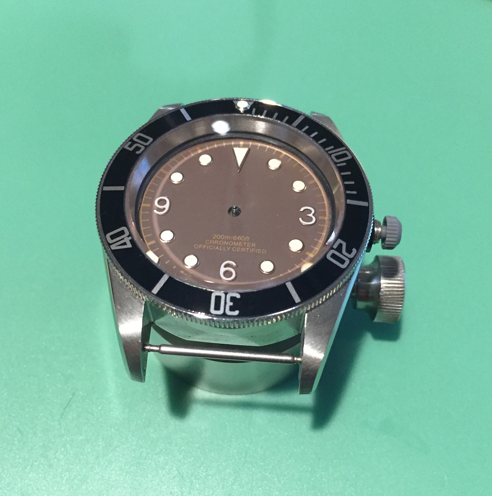

Here's the watch-in-progress, where the stem finally inserts correctly, now that the movement is spaced 'down' a tad relative to the crystal:
