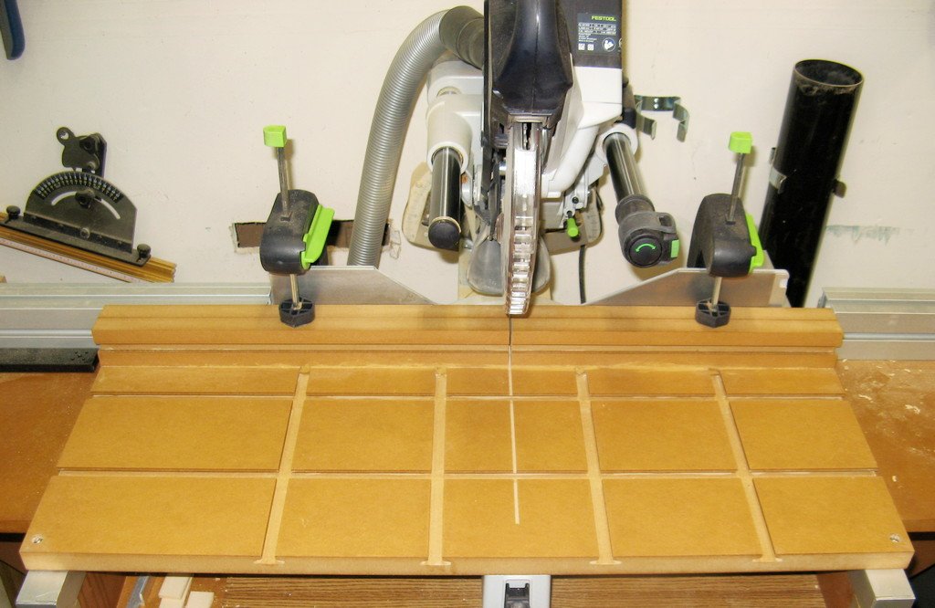

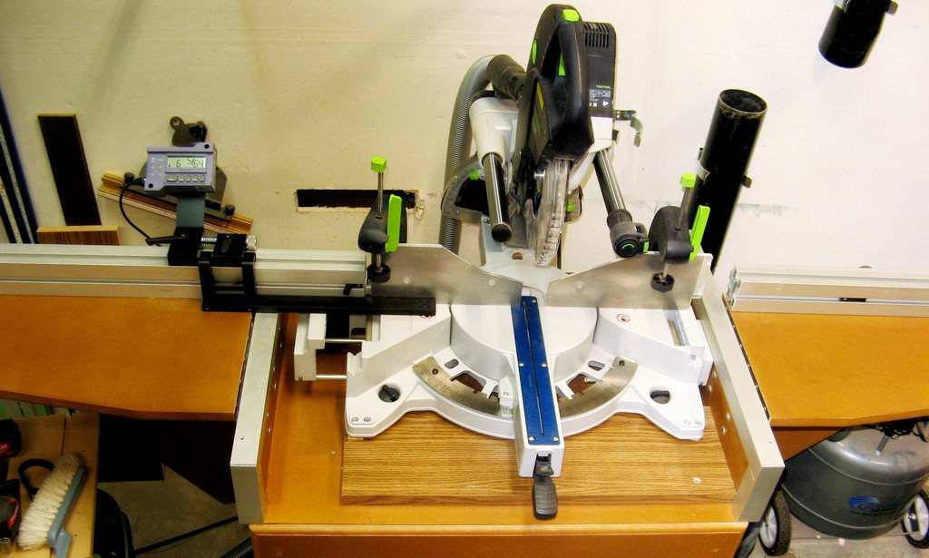

The first fixture board build I will discuss is one for my sliding miter saw. If I need to cut small parts I typically use the Incra Miter Express sled on my Shopsmith when accuracy/finish really matter or my bandsaw when I need something quick and dirty. Since it seems my Shopsmith is seldom setup in table saw mode it takes effort and time to configure and many times it disrupts the workflow on some projects that need repeated access to the drill press or drum sander. Dealing with this while one of the most accurate tools in my shop, a Kapex 120 sliding miter saw, sets idle is not very smart. However, without some type of additional holding capability for the parts it is far too dangerous to use for small parts. This is a perfect application for a fixture board and one using WoodAnchor slots and sliding nuts will be my preferred approach. The basic design should be general enough to work with whatever miter saw that you have so don’t tune out because you don’t have a Kapex.
Since I have some 1” Super MDF left over from my testing, I plan to use it for the base and fence but standard Baltic birch or MDF could also be used. Some design considerations include having enough slots in the right places for clamps and jigs but not so many that the structural integrity of the panel is compromised. Having one in the fence running the full length of the table seems valuable as is one not too far from the fence on the fixture board. Another thing that must be decided is how angled cuts will be performed. The saw can be rotated to make any cut +/- 45 degrees of the center line which is standard operation without the fixture board or it can be fixed on the center line and the work piece held at the desired angle of cut. I decided to hold the saw fixed on the center line and move the work pieces to the desired angle when using the fixture board. I don’t have a strong justification for it other than it just feels better when working with small parts and always knowing where the blade will cut by simply using the kerf in the table allows for a quicker setup. That being decided, slots about 3” from the center line on each side will be needed for holding and a couple of others distributed over the length of the table will finish the basic design as shown in the figure. I know that the slot placement seems kind of arbitrary but when you see the hold down fixtures and clamps it will make more sense. With a 1” table thickness I plan to set the depth stop on the saw at 7/8” to make a 1/8” kerf in the fixture board. At that blade height the fence will need to be a little over 1” wide to ensure complete cuts at the end of travel. I choose to just laminate two 1” thick strips 3” high to make the fence thickness an even 2”. That will limit my cut capacity from my normal 12” when no depth stop or fence are used to 9.25” with the 2” fence and 7/8” blade height. For small parts I think that is very acceptable.
With the basic design complete the next installment will cover the build and type of fixtures to used.

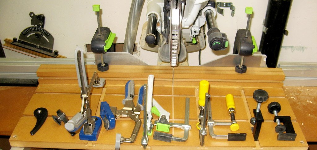

The next picture shows an array of clamps that I have used on other fixture boards which might be candidates for this one. First you will notice that most of these are standard clamps for ¼” T-tracks that have been fitted with a plastic sleeve which fits perfectly in the WoodAnchor slots. I am in the process of beta testing these prototype sleeves for ToolQuest and so far most are working out great. From right to left the first set of clamps are a very cost effective and compact set from PowerTec. They have a limited throat capacity but are great for holding small parts without not getting in the way.
https://www.amazon.com/POWERTEC-T-Track ... 785G&psc=1
Next up are the standard MatchFit clamps that many of you may already have. With the plastic sleeves you will be able to use them in WoodAnchor slots and still use them in dovetail slots without the sleeves.
https://www.amazon.com/Micro-DVC-538K2- ... 242&sr=8-3
Next are my favorite, the Festool Quick clamps that are used in MFT dog holes and track saw guide rails. When outfitted with the plastic sleeves they are my go to clamp for WoodAnchor slots as well.
https://www.amazon.com/Festool-491594-Q ... 233&sr=8-1
Next are the Kreg bench clamps configured to fit into 20 mm or ¾” dog holes. Here a Toolquest prototype adaptor is used to convert the base into accepting a ¼ - 20 screw that in turn screws into a WoodAnchor sliding nut. A little too big for small parts but works great for larger pieces.
https://www.amazon.com/Kreg-KBC3-BAS-Be ... 35&sr=8-71
Last is a ToolQuest prototype CAM clamp that I am testing which is a little awkward for small parts but works well on larger ones.

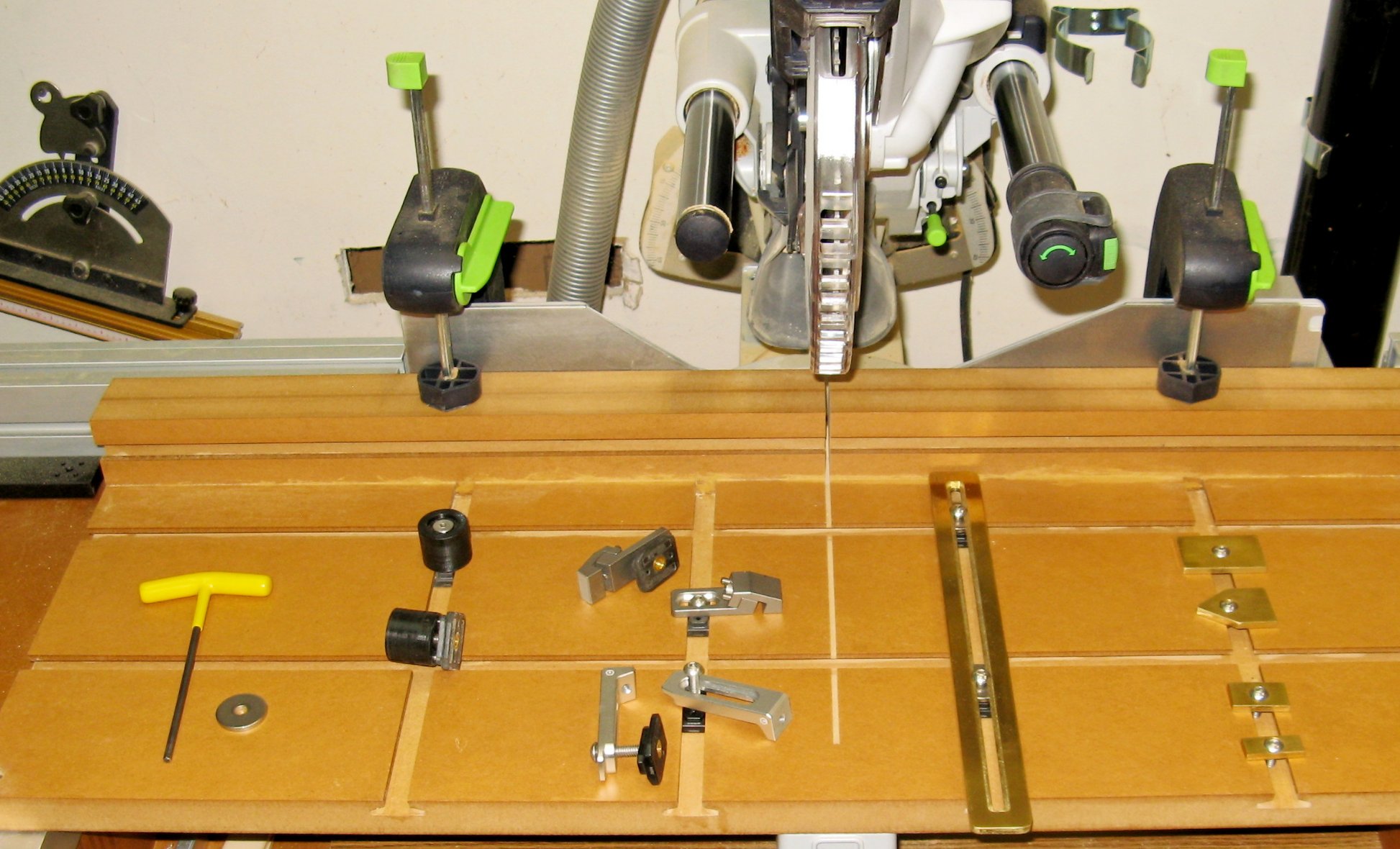

The next picture shows an array of stops and some miniature clamps that are very useful. Again from right to left the first are some stops I made myself using ¼” brass. They were fairly easy to make out of brass remnants off of Ebay and work very well as low profile stops with a button head screw and WoodAnchor sliding nut. Next is a 12” long slotted stop also out of ¼” brass which can be used as a secondary fence that can be set at most any angle using WoodAnchor sliding nuts in two parallel slots.
Next are the two most useful low profile clamps for small parts from Carbide 3D. At the bottom are the Gator Tooth clamps which grip small parts from the top.
https://shop.carbide3d.com/collections/ ... 5366461501
Then above the Gator Tooth clamps are the Tiger Claw clamps that apply lateral pressure against the work piece using a screw for adjustment. They work great with a WoodAnchor sliding nut for clamping pieces against one of the stops or the primary fence.
https://shop.carbide3d.com/collections/ ... 8957712445
Next are what we call floating dogs which are now in the ToolQuest prototype stage. They are used just like dogs on a MFT but can be positioned and tightened down anywhere along the WoodAnchor slots. As long as you have slots that are square two floating dogs in a horizontal slot can be used to establish a fence that is perpendicular to a work piece that is aligned by other two dogs that are in a vertical slot. Alternatively they can be positioned to hold a work piece at any angle on the fixture board.
I show a ToolQuest washer to indicate that you can make your own clamps out a wooden block that you provide, a button head screw and a WoodAnchor sliding nut as shown in the picture with a knob instead of a lower profile screw. Choose a block thickness that is slightly less then the thickness of the work piece and simple tighten the screw down on the washer next to the work piece. These clamps really work well and you can’t beat the price. I have a set of blocks for use with all the common stock thicknesses that I use as hold downs on my CNC router bed. I recommend using the heavy duty washers from ToolQuest. Fender washers are not nearly as good for this application. Another application of the washer is a make shift floating dog. Simply stack several washers on top of each other and secure them with a button head screw into a sliding nut. It can be positioned and tightened down anywhere along a slot just like a stop or floating dog.
