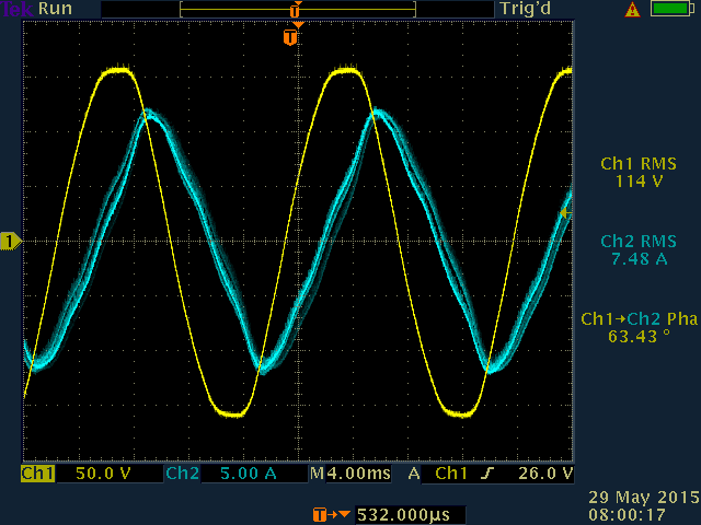

First up, we have a scope trace of my 2005 Mark V model 520 running at "SANDING DISC" speed, with a sanding disc installed but not being used. The yellow trace shows the line voltage, at 114V RMS measured. The current probe (blue trace) shows 7.48V RMS. So the power is 114V * 7.48A = 853W (1.14 hp), right?
Nope, that's wrong. The voltage and current waveforms are out of phase (by 63.4 degrees, according to the scope). You can multiply the instantaneous voltage by the instantaneous current, and indeed you will get the instantaneous power. But that same math simply does not work out when using RMS values -- those are time averages.

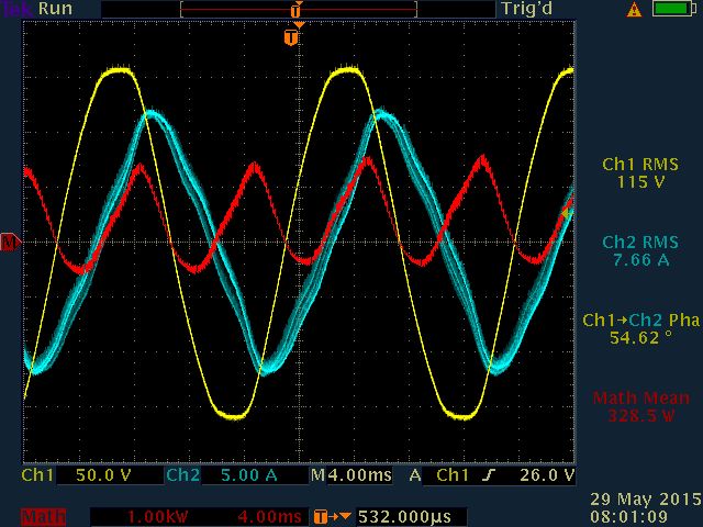

Next up, we have the same voltage and current waveforms, but the scope is set up to calculate the instantaneous power waveform as well. The vertical scale for power (red waveform) is 1000 W per division.
You can tell by eye that the average power is no more than 500W. In fact, the waveform is not sinusoidal, and the scope reports an accurate average power of 328.5W (0.44 hp). This number determines how much you pay the power company. Interestingly, you can see that the instantaneous power goes negative twice per AC cycle. This is due to the energy stored in the motor inductance, literally being pumped back out onto the power grid.

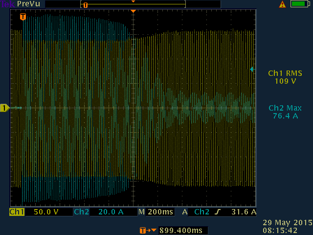

The first shot shows the voltage and current waveforms when powering up the Mark V with a steel sanding disc installed, and the speed control set to "DISC SAND". You can see that when I turn on the power switch, the current immediately jumps from zero to 76A peak (54A RMS). This is the "locked rotor" current of the motor. It remains near that peak level for about 800 milliseconds, and then declines rapidly as the motor spins up to speed.

You can also see that when supplying that much current, my line voltage (at the machine) drops by about 20V peak (14V RMS).

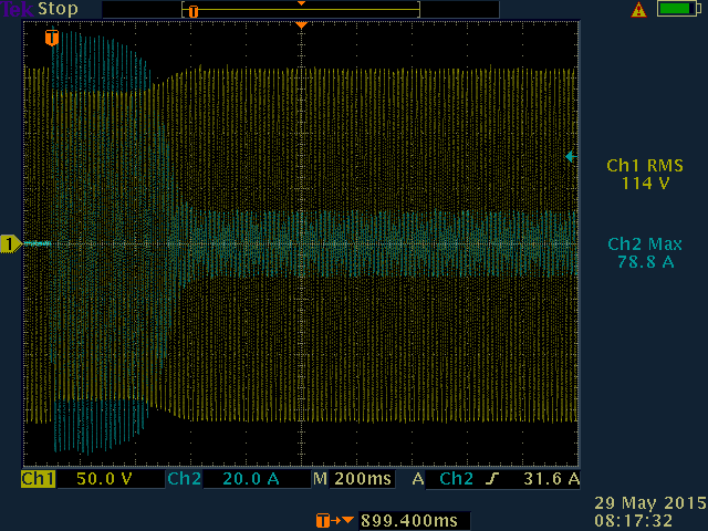

Next, I repeated the same test, but with the speed control set all the way to "SLOW". This didn't affect the start-up current magnitude, but it did cut the peak-current duration to less than 400 milliseconds.

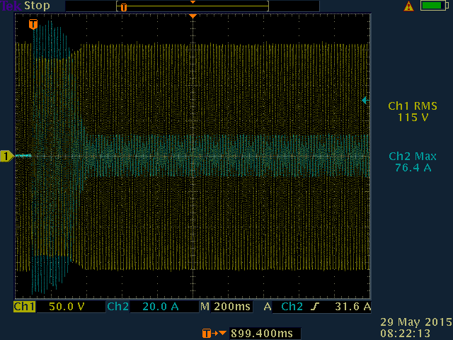

Then, I removed the sanding disk, and took another shot while still on "SLOW". The peak-current duration was reduced yet again, to about 200 milliseconds.

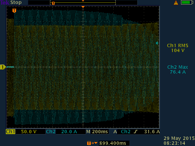

As a final test, still with no tooling on the spindle, I ran the test with the speed control set to "FAST". Now, the start-up current stayed above 70A peak (50A RMS) for almost 1.4 seconds.

So what I learned from this set of experiments is that the magnitude of the start-up current is always the same -- it's a function of the motor itself. But either adding inertia to the spindle, or cranking up the speed control, increases the duration of the peak start-up current.
