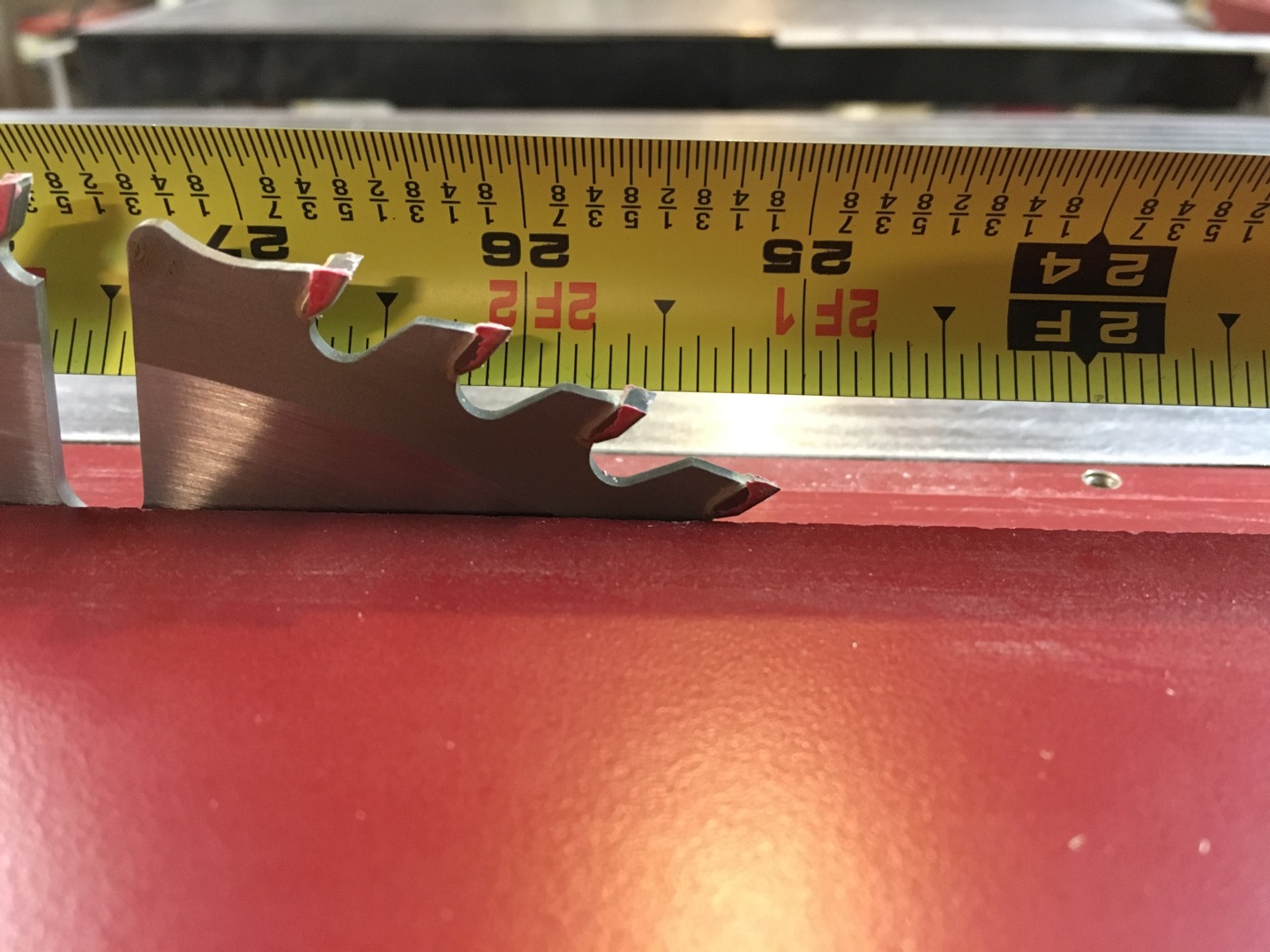

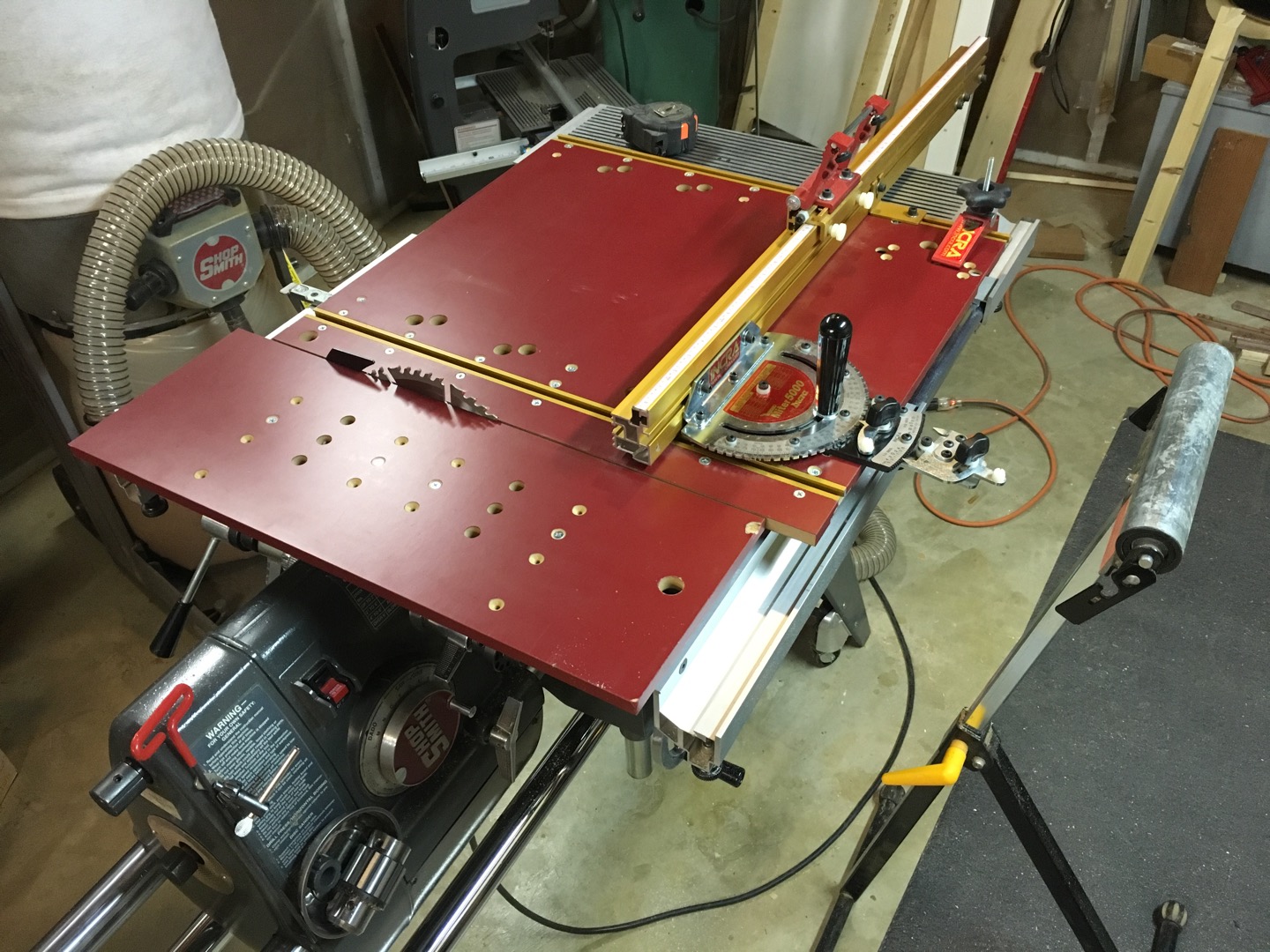

I continue to be amazed at the stability and accuracy of the Incra 5000 sled (thanks Jack Wilson). Today I was salvaging plywood from my canoe forms. Only the bases were straight. Big pieces of 3/4 ply that it seemed a shame to toss. Sled handled them great and turned them into perfect rectangles. Wish I'd measured before I started but after cutting off the curved parts the resulting panels were as large as 21 x 20.
I'm not sure what the advertised cross cut capacity is but I set up afterwards and think you could get 25 inches. The front of the miter bar has a T-nut so it won't pop out even with most of the bar and sled hanging off the back. For my use I was able to go without any additional support beneath the sled, but as shown in the photos below it is a simple matter to set up a roller stand to give I feed support if you are maxing out the cross cut capacity of the sled. Sorry for the double photo. I posted form my iPhone and I'm not sure what happened.
