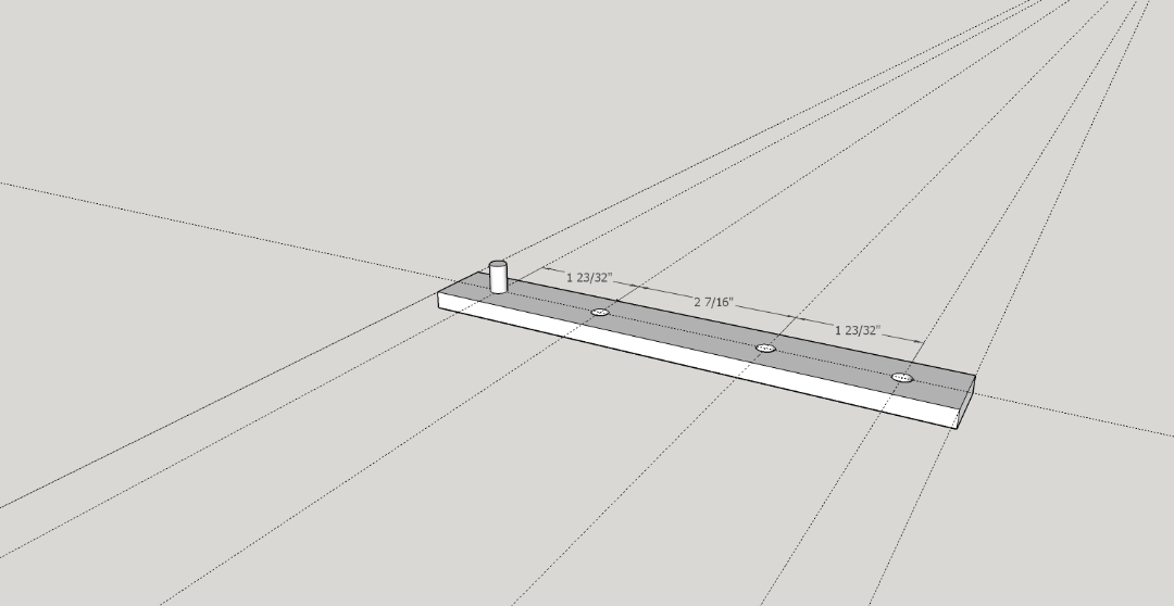

Could you just annotate (correct) this sketchup drawing of my template.
Measure from the edge of the hole for a more accurate measurement.

dusty wrote:Could you just annotate (correct) this sketchup drawing of my template.
Yes, if you can live with measurements that aren't center to center. For instance, I can throw some calipers and measure the diamters of the pegs/holes and the NEAREST measurements between them. But not on center. Will that do?

The 'top' two holes will suffice. Measure the distance between the outer edges of the holes. Subtract the radius of each hole. That be the c-c spacing. IIRC the original holes were 5/16 for 1/4" screws.
Now as for the casters 'clearing' the floor, that is not necessary. There is slop in the caster sleeve etc. and although the wheels may rest on the floor, there is no weight on them.
As Ed said, first up = leg 1/4" off the floor, second up = leg 1/2" off the floor.
IIRC the new holes s/b about 1 5/8" above the original holes(c-c).

Here are my measurements.
The peg is .280 in diameter.
The first hole is .290 in diamteter.
Looking at dusty's sketch, the distance between the rightmost side of the peg to the rightmost side of the first hole is 1.706.
The second hole is .245 in diameter.
The closest distance between the first hole (right edge) and second hole (left edge) is 2.182.
The third hole is .286 in diamter (I suspect the first hole was originally the same diameter and may have been accidentally enlarged by .004 when I was using it as a drill guide).
The closest distance between the second hole (right edge) and third hole (left edge) is 1.436
Sorry these numbers don't seem to make a whole lot of sense. I've taken multiple measurements of each and it is hard to get repeatable numbers.
Re: Caster Installation Guide & Drill Bit p/n 556425
Is it accurate to say the drill bit supplied was 9/32"?
If so, the increment is 1 11/16" (1.688).
All holes are 9/32" (.281).[All but one]
That makes sense with Dusty's 2 7/16 dimension.
i.e. 2 7/16 + 1 11/16 = 3 18/16 = 4 1/8 = caster hole spacing.
The way I see it. ;)
