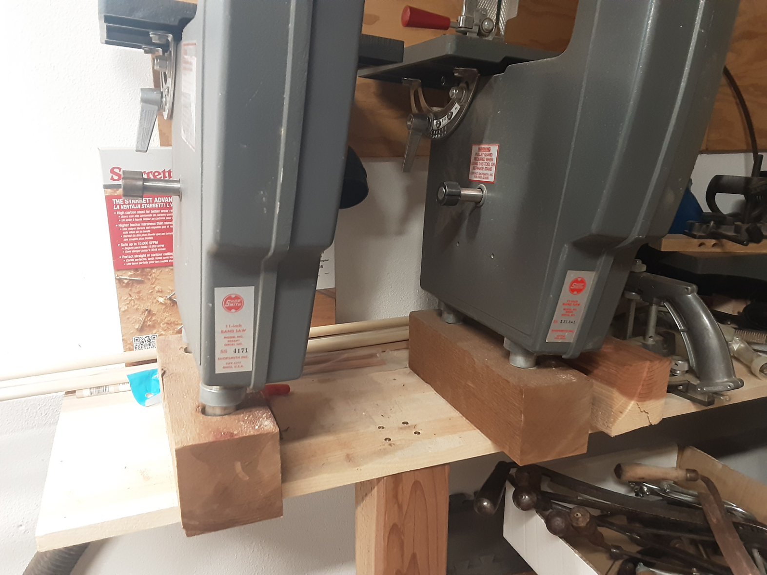

I have two cast iron tabled bandsaws and for storage the limit of closeness is the table. If I had the larger aluminum tables I'd need more space on my SPT shelf.
- 20200619_201150.jpg (1.18 MiB) Viewed 2758 times

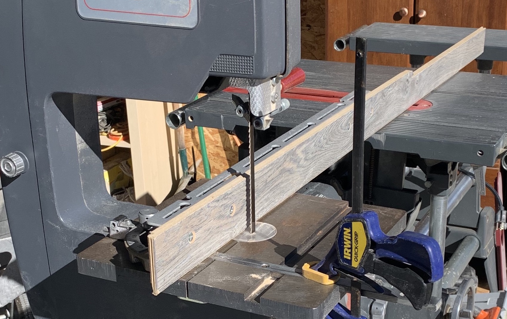

I use the the cast iron one with a 5/8" blade for resawing and use the aluminum with a 1/4" blade for curves and such.
I have no fence for my aluminum table.
I use a miter gauge and extension with a piece of straight composite flooring for a fence. It works great!
I still prefer the cast iron over the "upgrade".
Dan

I notice you have an Irwin Quick Clamp holding the end of the Miter Gauge Bar. Do you have a problem with it trying to lift up out of the slot?

no, not lifting out. I use the clamp to keep it from sliding forward or back.
Re: Bandsaw: New style table vs. old style table?
The set screw in the middle of the miter bar is tapered, if you tighten it, it will make the bar wider and lock it in the slot.AEA wrote:Rus:
edit, actually the setscrew is straight, the hole is tapered.

Oh good grief, thanks. That will certainly help when I do wider stuff.
Of course I feel a bit silly, I guess I need another lesson in humility.
