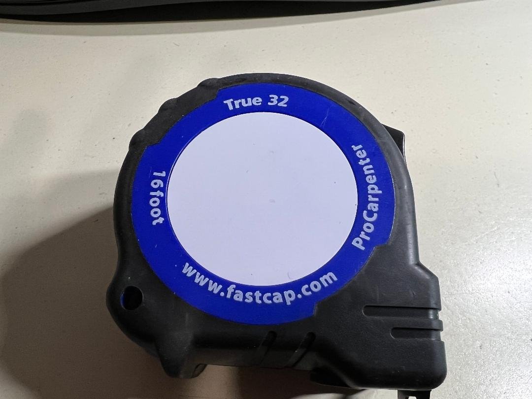

If you don't you will soon. If you work in both imperial and metric or just metric this 32mm number will come up a lot especially in cabinetry work where I feel you are better off to just work in metric, conversions can be a pain.
So you are work in a base 32 system and well 32mm, then 64mm, 96mm, 128mm, and now I have to start adding. It really get bad when you get to say 1152mm, is that a 32mm increment? Or say you have something that needs to be about a foot tall but it doesn't have to be right on 12" but it would be nice to be on a 32mm increment. So you say "Alexa" how many mm is 12", she answers 304.8mm, well we know that isn't going to be a sweet 32 number.....
So here is where a rule that is a TRUE 32 comes in. If I look at the rule I see that the close 32mm numbers are 288 and 320, so I can just pick one and I'm off to work again. Yes there are other ways but lets look at this way.
Fastcap, a company I have both loved and hated over the years but at least they do have something that I find useful. This is their Pro Carpenter True 32 tape measure. Yes it has the usual pencil sharpener, notepad, rubber casing, dual locks etc.
Those little dots are the 32 increments, in case you haven't figured that out yet.
So now you know what this is about. You can decide if this might be of help or just a waste of time.

I'm amused that the label says it is a "16foot" tape but there are no other imperial markings!
