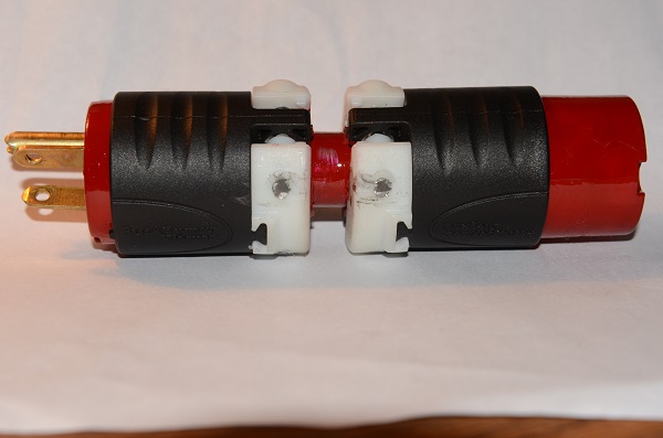

As a reader who has gained much knowledge from everyone here I say THANK YOU.
So as a minor token to pay it forward I thought I’d contribute for a change.
Last week I pulled the trigger on a Mark 7 purchase to replace my 1980 Mark 500. (for the cost difference on an upgrade I’m giving the 500 to my son.). I was looking at a Power Pro, 520, and double tilt upgrade to the 500.

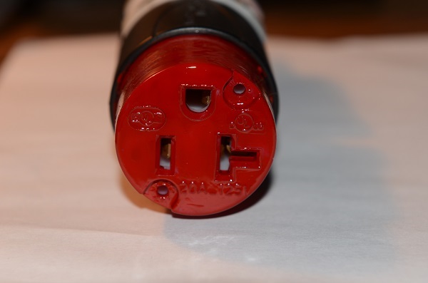

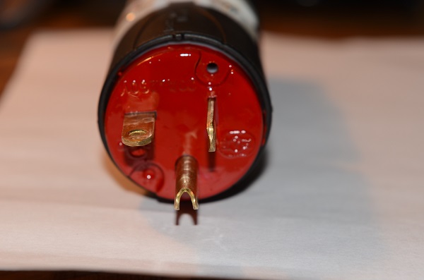

In planning for its arrival, I was thinking of the 120v vs. 240v supply. I’ve read that you can change the plug, make an extension cord etc. to supply it.
I’m going to try the attached pigtail that I made up. This way I can use a normal 120v 12ga extension cord to supply either 120v or 240v. Plus I do not need to replace the plug on the Mark 7 and can go with either voltage anytime.
I understand the danger of this being used in the wrong way (a 120v tool) but will ONLY use it on the Mark 7. (Which is why I painted the receptacles red)
Hope this offers another option, and thanks again.
Steve

- Posts: 35598
Kudos on using 20A plug and 20A receptacle.
IMHO this is a good 'solution'.
However it breaks 'the rules'.
The hazard is as you described, improper use by an unaware user.
For that reason, keep it locked up when YOU are not using it.

- Posts: 35598
The '5' designated parts are 125v. The '6' designated parts are 250v.
The '2 single pole' recommendation is contradictory. They should be ganged(i.e. 2 pole). Overcurrent in either wire causes both breakers to open.
10A breakers for residential house breaker panels are not common since the purpose of the breakers is to protect building wiring and #14 is a minimum size wire which requires 15A breaker protection.
Using 10A over current devices to protect the PP motor makes sense if it's max current draw is 7A, but should be between the receptacle and the cord.
That would require an additional enclosure to contain the 10A breakers.
So combine surge protection with 10A breakers.
Question I have is, what is the max current draw at 125V?

Would it help if you teather the pigtail to the SS power cord (like a chuck key on a corded hand drill) to reduce the likelyhood of it being used for anything else?cooch366 wrote: I understand the danger of this being used in the wrong way (a 120v tool) but will ONLY use it on the Mark 7. (Which is why I painted the receptacles red)

Good ideas....
Good idea on the teathering to the power cord of the MK7. I'm going to have some sort of removable attachment that I can leave on the power cord when I'm not using it and be able to easily remove it to plug into the 220v outlet. This will allow me to use it with a 120v extension cord. I plan on being religous about it's use and storrage. After thinking about this, I can understand why things like this are not "available". Could be dangerous in the wrong hands.
A couple of questions about the 10amp breakers. What is the advantage / benefit of using them? Is it so they trip out eariler? Also why single pole breakers? If it's wired 220v shouldn't you use a double pole breaker? Wouldn't is cause a problem and/or dammage if one of the singles tripped and the other didn't?
Thanks for the info Ben, I too will give Shopsmith a call to try and understand their thinking and make sure I do this right. Last thing I want to do is mess us the motor.
Also could someone shed some more light onthe advantage / benefits of the surge protection that has been talked about here? What is needed and how to hook it up. I'm thinking that it is probably short money to install if offers additional insurance for the motor. Any info or instructions would be greatly appreciated.
Thanks again... Steve

If you made it longer you could plug it back into itself forming a loop around one of the bench tubes.
When I made mine, it was much longer than yours and also acts as an extension cord. It still can be coiled and hung from the back bench tube. I too added red to the plugs.
Rob in San Diego
- Posts: 35598
The surge protection is to protect the electronic components in the power supply from over voltage spikes coming in on the power line. Those spikes are not a problem for an induction motor.cooch366 wrote:Good idea on the teathering to the power cord of the MK7. I'm going to have some sort of removable attachment that I can leave on the power cord when I'm not using it and be able to easily remove it to plug into the 220v outlet. This will allow me to use it with a 120v extension cord. I plan on being religous about it's use and storrage. After thinking about this, I can understand why things like this are not "available". Could be dangerous in the wrong hands.Yep!
A couple of questions about the 10amp breakers. What is the advantage / benefit of using them? Is it so they trip out eariler? Trip at a lower current, not 'earlier'. A breaker sized closer to typical(normal) operational current will trip when current exceeds that(10A) but a larger breaker(15A/20A) might not. Also why single pole breakers? If it's wired 220v shouldn't you use a double pole breaker? I see it that way also. Wouldn't is cause a problem and/or dammage if one of the singles tripped and the other didn't? The problem with 'unganged' breakers is that a single pole will only remove power from one of the two 'hot' lines.
Thanks for the info Ben, I too will give Shopsmith a call to try and understand their thinking and make sure I do this right. Last thing I want to do is mess us the motor. Do let us know how that goes!:D
- Posts: 35598
[quote="SDSSmith"]If you made it longer you could plug it back into itself forming a loop around one of the bench tubes.]
How does a 250v plug fit into a 125v socket?
Whoops, it shouldn't! I know mine won't as I have a twist lock on the male end. But my cord is long enough to coil around the bench tube to make less available for knuckleheads to mess with, cooch can carry his around in his pocket.JPG40504 wrote:How does a 250v plug fit into a 125v socket?
