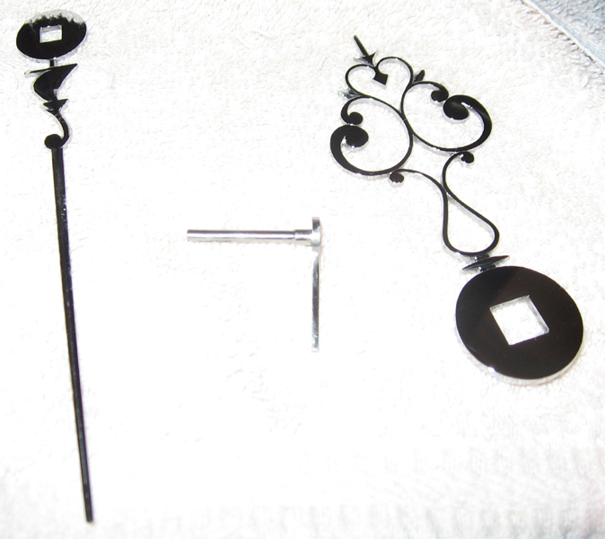

I have a series of lapping plates, glass plates with abrasive paper glued on. To achieve a "black polish" I work through the grades to 2000 grit and then use green rouge. This is a finish that is mirror like and under certain lighting conditions the metal appears to be black instead of the bright silver. The photo below is an example. This sort of finish would be overkill, difficult to maintain, and probably would impair the function of the carriage locks.
In my opinion anything finer than 400 or 600 grit is counterproductive.
