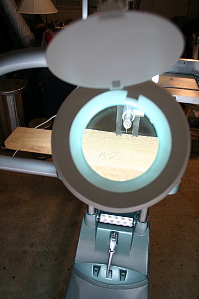

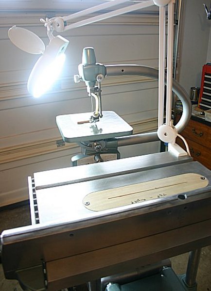

You can become a 'quadrafocal' and utilize this type of florescent lighting w/magnifieron an adjustable arm. Got mine on sale for $25. Works great and you can move it out of the way easily when not needed. I use this light / magnifier all the time on projects that require good localized lighting and/or close-up view.
[ATTACH]8142[/ATTACH]. . . [ATTACH]8141[/ATTACH]

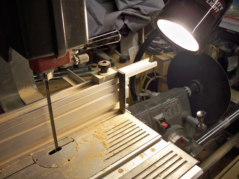

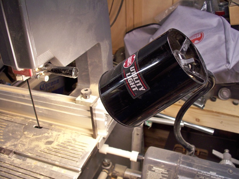

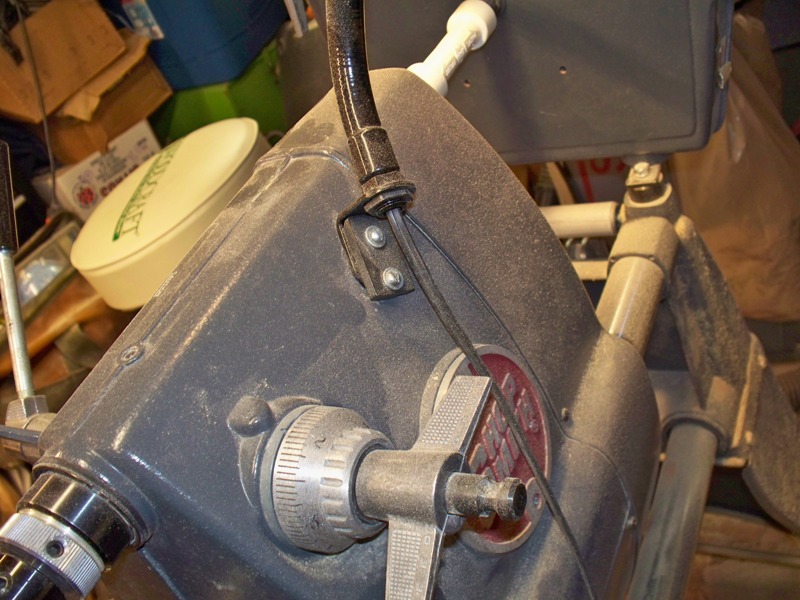

I use the Shopsmith Utility Light mounted on my headstock when I am using my band saw, drill press and also when in lathe mode. I mounted the bracket holder on the headstock and used machine screws and lock-nuts as the screws that came with the bracket worked loose soon after I had installed it. Below are some pictures of my setup and it works fine for my 63 year old eyes. Excuse the sawdust as just had finished a project and had not cleaned up yet.
[ATTACH][ATTACH]8146[/ATTACH][/ATTACH][ATTACH]8147[/ATTACH][ATTACH]8148[/ATTACH]
