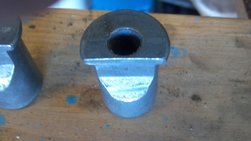

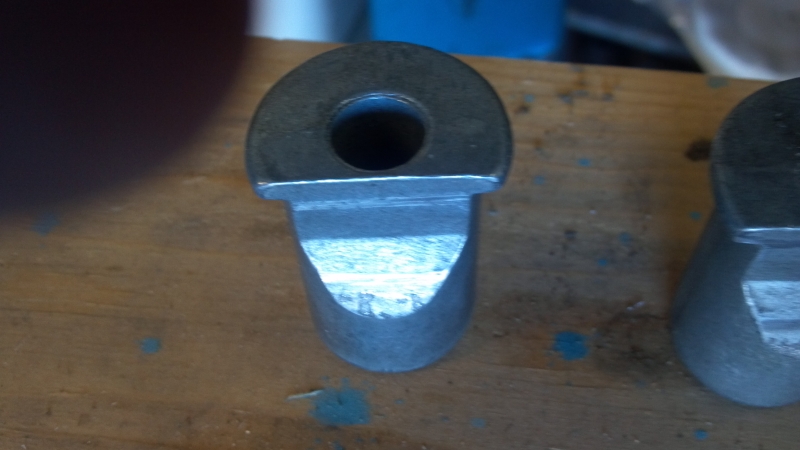

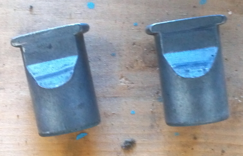

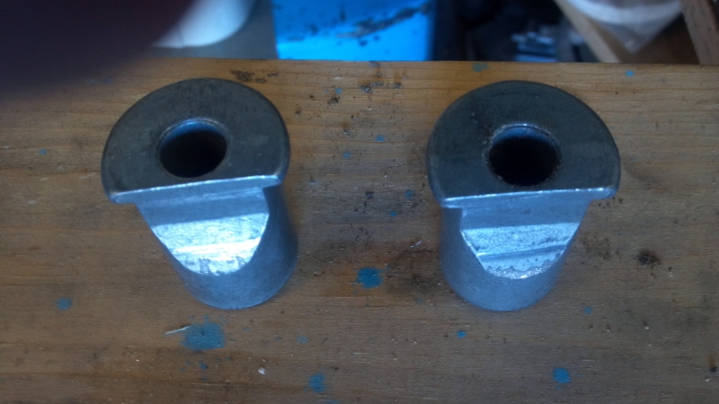

My headstock started making the pop sound when loosening the headstock lock.
Here are photos of the lock wedges.
Opinions on course of action??
[ATTACH]16518[/ATTACH]
[ATTACH]16519[/ATTACH]
[ATTACH]16520[/ATTACH]
[ATTACH]16521[/ATTACH]
Thanks
Headstock Lock wedge condition

- Posts: 21481
Because of the way the wedges work, I don't believe you can take off too much (within reason of course). Bottom line, if it works - great. If it doesn't you need new wedges.wa2crk wrote:Clamp 'em in a vice and file the sloped area flat. Should be as good as new. Don't take off excessive material.
Bill V
This is one of the simplest fixes I have done. With a flat file, the material at the top and bottom of the wedge will be the first to be removed. With even pressure, checking that the material is being removed evenly on each side, just keep filing until the top and bottom filed areas meet leaving a flat angled surface. Less than a minute job in most cases for each wedge. I believe "close counts" in this case.

Thanks I have them filed Close enough I believe. I'll find out when I reassemble. Since I had pretty much everything apart to change the bearings out I decided it was time recondition my '55 "Old Blue".

Good to hear, Bill. I was wondering the same thing! It's not that 8.95 per piece is all that expensive, but when you start adding up the cost of all the parts that you can't repair - it gets to be pretty important to salvage those you can ...billmayo wrote:This is one of the simplest fixes I have done. With a flat file, the material at the top and bottom of the wedge will be the first to be removed. With even pressure, checking that the material is being removed evenly on each side, just keep filing until the top and bottom filed areas meet leaving a flat angled surface. Less than a minute job in most cases for each wedge. I believe "close counts" in this case.

Not to mention shipping, and the wait time for parts to arrive. I filed them flat in less time than it would have taken me to order them on line. I see that as a a $50 savings. 2 Carriage wedges, 2 head stock wedges, shipping, etc.bdeweese wrote:Good to hear, Bill. I was wondering the same thing! It's not that 8.95 per piece is all that expensive, but when you start adding up the cost of all the parts that you can't repair - it gets to be pretty important to salvage those you can ...
