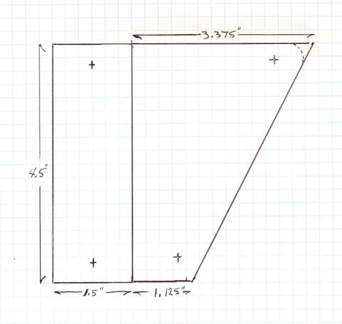

Shopsmith Retractable Casters.
The 10ER retractable casters are for straight vertical end cabinets/benches. They can be mounted on the inside or the outside of the ends.
Here is a drawing for using Mark V retractable casters on a vertical end. It came from http://ph.groups.yahoo.com/group/Shopsm ... w/dcf6?b=5
It works real well. I used 1/8" metal plate to make a set for the outside of a cabinet.
- Mark V Caster Adapter.jpg (18.89 KiB) Viewed 10544 times

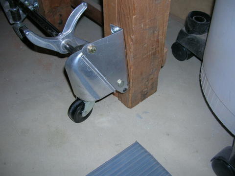

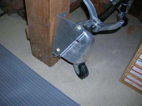

Here are pictures of the left and right bracket using Mark V retractable casters:
a1gutterman wrote:Hi Bill,
The yahoo link only brought me to a sign-up page. I could not access the photos?
- Left bracket MK5 to 10ER.jpg (23 KiB) Viewed 10585 times
- Right bracket MK5 to 10ER.jpg (19.92 KiB) Viewed 10537 times
