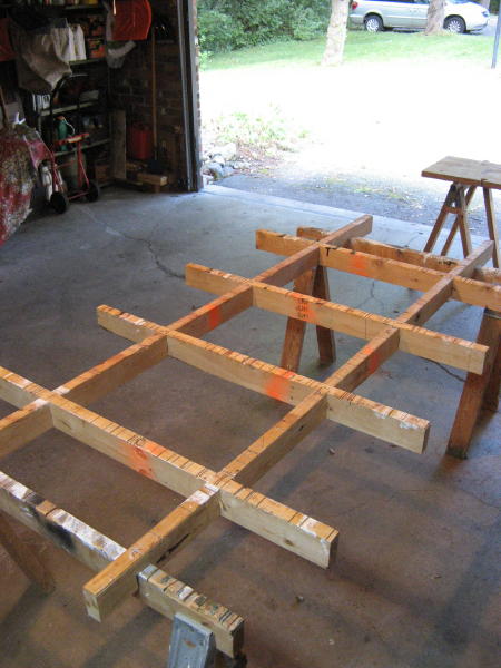

There've been a couple of threads recently dealing with this topic. My shop is in the basement and a full sheet won't make the journey so breaking down sheet goods in the garage is how I must work.
I was surprised that the discussion didn't cover methods of supporting the stock while it's cut.
For a long time I placed 2 x 4's on the garage floor, laid my plywood or whatever on it, and used a straight and circular saw. For awhile I I used pink rigid insulation instead of the 2 x 4's.

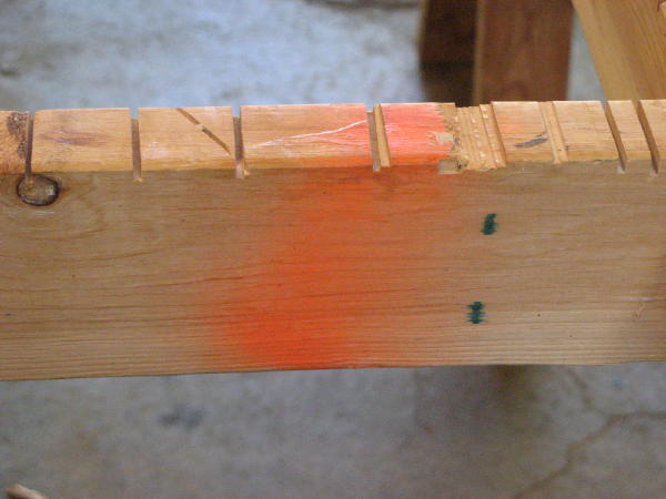

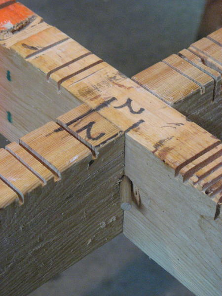

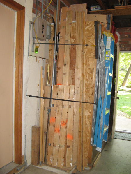

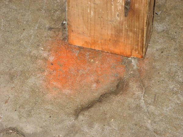

Finally I read an article in Woodsmith and built this unit. Four 2 x 4's put together with half lap joints. They rest on standard saw horses. I cut the half laps with a circular saw, so they joints were pretty rough, I labled each so they'd fit together easily in future use. I cross drilled each joint and stick in a 1/4" dowel to prevent the joint from coming apart if I put weight on just one end. I also painted the floor to position the saw horses. Finally I've gave them a shot of orange paint so I wouldn't accidentally use a section for something else. When not in use the rig stands up in a corner of the garage.
I have a full sheet of MDF on edge against the wall that I can add to this and use the unit for finishing or assembly. I really like this unit. It is soooo good not to be working on my knees!
Because it comes apart so easily I can throw it into the van and take it to a job site.
But I always trying to see how others work.

I like that!!!!!:cool:
That's a very decent solution to a problem that many of us face every time we start a plywood job.
Here in Arizona I believe I could even leave it out in the weather.
Occasionally, we host a family, outdoor gathering that always requires a large table for the eats. I can see this with a sheet thrown over it and covered with "the makings".

If I can find room for the 2x4s in my "shop" I will build one for sure. I use 4 stands with 1x12s for breaking down 4x8 sheets.
I can handle them all by myself since my Toyota Sienna (my truck) will carry them inside when the seats are out. I back up to the stands and just slide the sheets out.:D

That's pretty much the same system I have used for years since I have the same basement shop problem. Only instead of saw horses, I use two B&D Workmates to hold one 4 foot 2x4 each. I then have two eight foot 2x4's interlocked with half laps. Then I have two more 4 foot 2x4's half lapped into the eight foot 2x4's. Works like a charm. And I've been cutting for years and still don't need to replace any of them. The only reason I didn't use saw horses is because I already owned the Workmates.
I too don't like working on my hands and knees.
Oh, and I also place a sheet of plywood on top as an extra large work surface.
