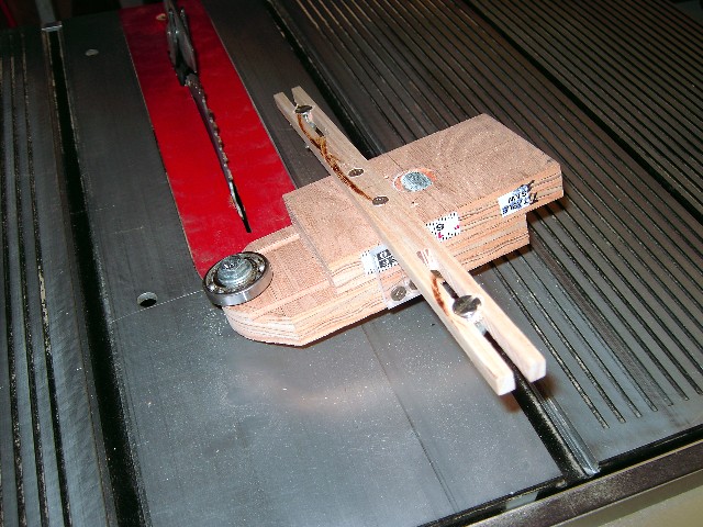

Here is one I made a couple of years ago. It's from Shop Notes and I don't remember which issue, sorry. I use it on the table saw and the band saw. It works great.
Thin Jig 1.jpg (83.31 KiB) Viewed 7371 times
Thin Jig 2.jpg (112.68 KiB) Viewed 7346 times
George
Ft. Worth, TX.

The jig George shows, can be found on p. 46 of TableSaw (Tough Cuts Made Easy. It looks like it can be found in a regular issue Volume 16, between 91-96. Mine don't go back that far as I'm fairly new to Shopnotes.

A couple of notes: The Shopnotes Magazine showing Curious George's jig is issue 94. The article goes on to explain this jig is used for long thin strips (defined as over 30" long)
The Rockler video shows cutting short strips with a device like that from Shopnotes/curiousgeorge. I couldn't help but notice the the fellow on the U-Tube video uses a splitter and anti kickback pawls. The Rockler guy doesn't have either of these safety devices. Also the Rockler guy removes the downward pressure he had on the board and also shifts body weight (reaching for the switch?) his push stick and actually backs it up thereby allowing the kickback. Wow! Asking for it!
Back to the Shopnotes article. To make thin strips less than 30" long they have designed an 'L' shaped block 18" long complete with a handle and a replaceable stop to keep the strip from coming backwards. The long leg of the 'L' rides parallel to the table on top of the workpiece while the fat leg of the 'L' rides the fence and the table. In this situation the strip is cut off between the saw and the jig, while the long leg of the 'L' holds down the whole workpiece. The beauty of this jig is twofold. Only one setting of the rip fence and "there is virtually no chance of kickback". (quotes from the SN article)
Importantly - the use of both jigs shown in Shopnotes use a homemade splitter and zero clearance insert. The article even shows how to make these devices.
I agree with Paul Heller - in that neither of the jigs shown will not, by themselves, offer safety. It is splitters, anti-kickback pawls and vertical hold downs that will add safety.
