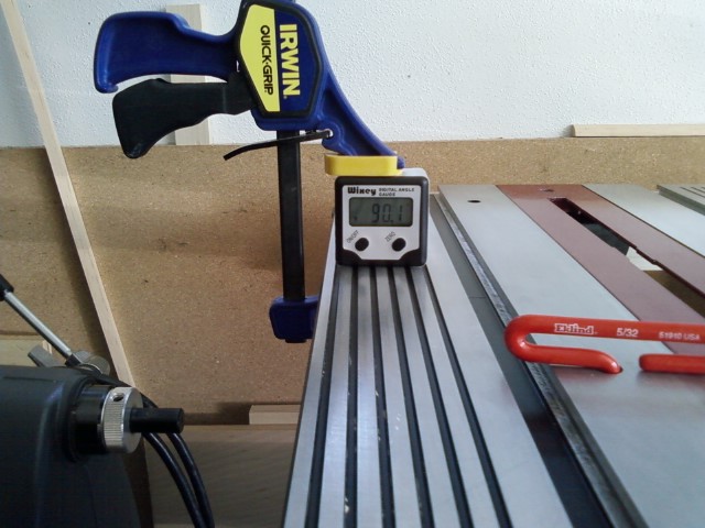

I bought a Wixey "dig-a-guage" and i've had good luck attaching it to the table by just using a small bar clamp, using very little pressure to hold it down flat to the table. The extra step, (clamping) makes it hands free so you can tilt the table with one hand and lock it in place with the other. (ShopSmiths should come with one of these guages, see my SS350 post):cool:
Now, by looking at my picture, i've clamped it to the left side of the table because there's flat spot underneith where the side of the table recesses for my my clamp to be seated square. (crappy description I know but go out to yours and see what I mean:) ) If I attach it to the right side of my table, I have to use a small block of wood under the table for the clamp to seat properly. REMEMBER, NOT TOO MUCH PRESSURE OR YOU'LL CRUSH THE DARN THING!!!!!

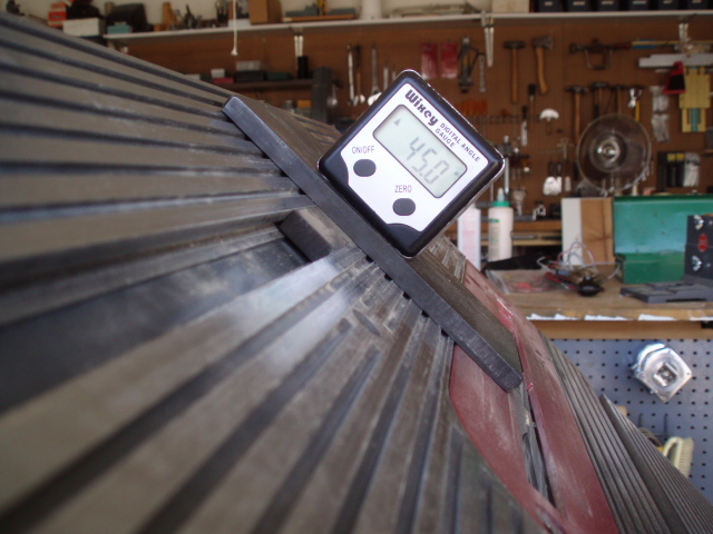

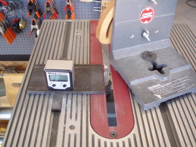

If you have a Tenon Master, take a look at that base assembly. It works well with the Wixey.
[ATTACH]1317[/ATTACH]
[ATTACH]1318[/ATTACH]
Wixey at 45 Degrees.JPG (153.51 KiB) Viewed 14837 times
Wixey on a Tenon Master.JPG (153.13 KiB) Viewed 14834 times
