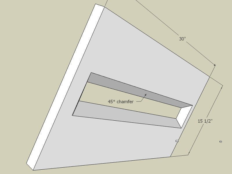

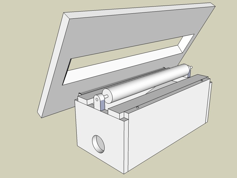

I am in the process of making a drum sander table. I have started drawing the plans in Sketchup. So far I haven't added any measurements, but the table top needs a 2" wide slot on the top that has a 45 degree chamfer to the bottom to accommodate the sanding drum . Any suggestions as to the easiest way to accomplish a captured chamfer?

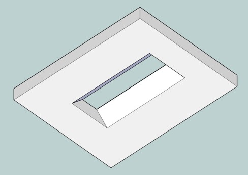

George, I'd start with a rectangle as a cross section of the top, draw your champhered opening on it and then use push/pull to extrude the sides, then draw a closing polygon and extrude the rest of the way. Once it's all extruded you can erase the lines of the joining solids to make it "one"... Kinda like this if I understand you right...

[quote="curiousgeorge"]Tom,
I see what you are saying in Sketchup, but I guess I wasn't clear with my question. What I need are suggestions as to how to go about actually cutting the chamfered slot in the top. Such as]
Sorry for the missunderstanding George, I think I'd be tempted to build it out of 4 pieces and dowel it together.

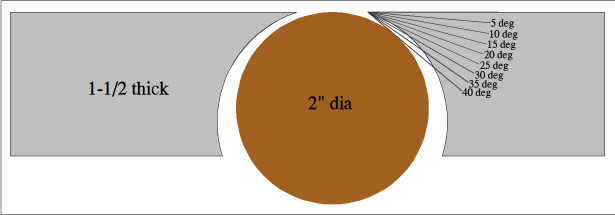

Sometimes it is very importain to make sure you really know what things look like to make plan of how to build it. Just for information purposes I did a quick mechanical drawing of a top and sander and put 5 deg steps as if it were cut in a straight line. I don't know if that is what you expected?? Trying to cut say a 45 deg opening starts making the opening have to be a lot larger then I think you want it.
[ATTACH]2321[/ATTACH]

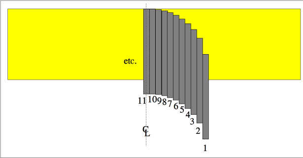

I'm not saying this is a solution for you but here is another way to look at it. The following sketches show making a series of slices taken off around a phantom circle just larger then the sander.
[ATTACH]2322[/ATTACH]

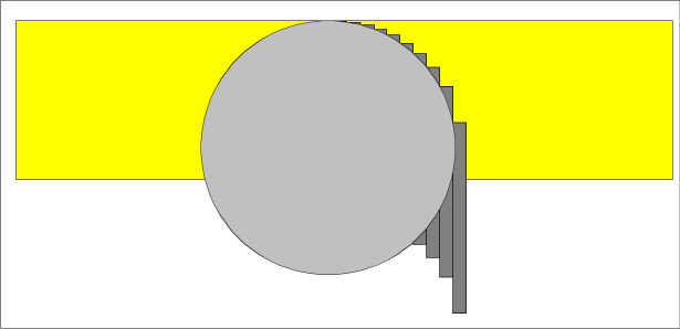

Once the heights/depths are determined then one could cut as shown in order from 1 to X, shown is half of the cuts. In this case I used 1/8" cuts but again this is only an example.
[ATTACH]2323[/ATTACH]

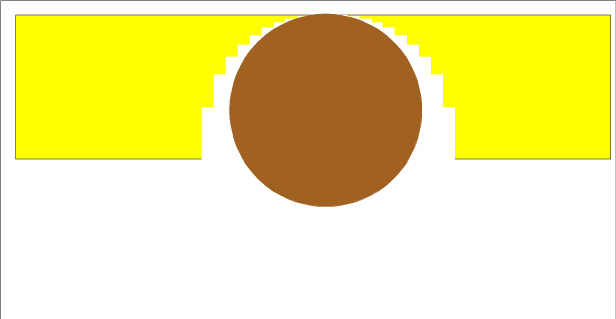

The results would look something like this.
[ATTACH]2325[/ATTACH]

Hi Ed,
No. Actually this is the 18" V Drum Sander kit from Stock Room Supply and it is their table top design. I do like your rounded out solution though.Are you modeling this after the one Nick has in one of his books?
