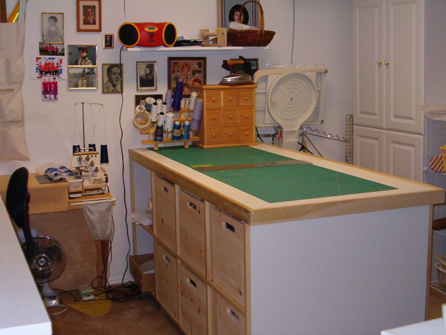

You are right on there, 8iowa! I put one of these fixtures in my wife's sewing room for more light. I was a little sceptical at first, seeing the scrawny narrow little bulbs. But when we turned it on - it knocked our socks off! Almost have to wear sunglasses in that room. Only one problem. The light plays games with the little TV she has in that room. The TV changes stations all by itself.
[ATTACH]104[/ATTACH]
- worktable and folded ironing board.jpg (119.54 KiB) Viewed 27761 times

The most obvious difference between the two types of flourescent tubes is the diameter of the tubes. The tubes used with the new electronic ballast are only 1" in diameter. The older style tubes are an inch and a half. But, as 8iowa says they give better light. And boy! they seem a lot brighter! Sorry for using the term "bulbs" in my earlier post!

Shop Lighting (Sewing Area)
If my wife sees that sewing room, with or without good lighting, I know what one of my next projects is going to be.
That looks like a real nice work/storage table.
