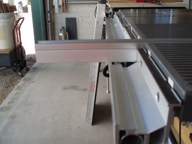

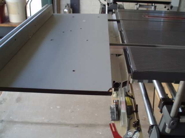

Every now and then I have wished that there was an extension table with a T-Track.
Well, it won't be long and there will be.
Hawk came up with a situation where he needed to use the cross cut sled to cross cut stock that was 24" wide. This exceeds the capacity of the Shopsmith Cross-Cut Sled because the miter bar becomes disengaged when the sled is pulled that far back. This also spurred me into action to resolve my long time issue.
This modification provides for a sled with virtually no unwanted movement of the miter bars in the T-Tracks. I have mounted dual miter bars on other sleds and it works well. This installation will be a challenge because it relies on accurate alignment of the T-Track on the extension table to the T-Track in the main table.
I am in the process of attaching a T-Track to the left side of my right hand extension table. The T-Track will be installed in such a manner that it can be removed if not needed or it interfers with a different setup.
I am also going to modify my sled to accept a 2nd miter bar.

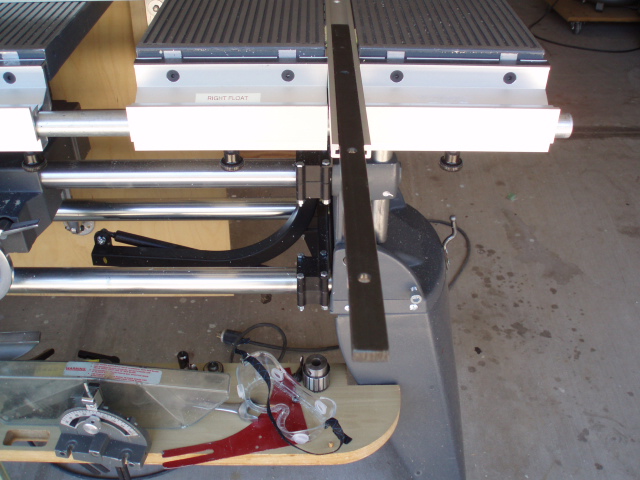

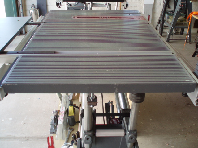

I will no longer yearn for an extension table with a t-track because I now have one.
I used a t-track that I bought from Shopsmith years ago. Temporarily relocated a miter bar from a small dual miter crosscut table that I have in the works and a piece of aluminum angle iron.
The t-track is longer than the Shopsmith table (infeed to outfeed) and I didn't cut it off; I just used it that way for reasons that will become apparent.
With this t-track there, I just had to find a way to employ it. I modified my crosscut sled to a two rail system. I believe I get getter lateral stability. Time and a couple projects will be the proof (good or bad).
- Longer T-Track.JPG (144.66 KiB) Viewed 9378 times
- T-Track Installed.JPG (157.15 KiB) Viewed 9356 times
- Nice Expanded Work Surface.JPG (133.77 KiB) Viewed 9384 times
- New Crosscut Capacity.JPG (145.71 KiB) Viewed 9363 times
- Crosscut Capacity Expanded.JPG (164 KiB) Viewed 9380 times
