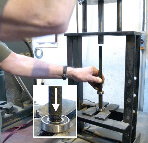

If the spindle knob/collar isn't the issue, then you're right Jeff -- the bearing isn't properly seated on the spindle. Occassionally the bearing walks away from the shoulder against which it rests.
[ATTACH]169[/ATTACH]

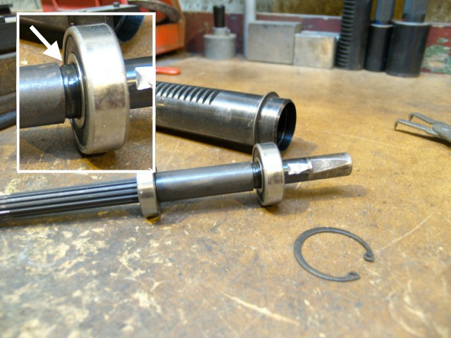

Remove the knob/collar and the bearing retaining ring at the business end of the quill and pull the spindle-bearing assembly out of the quill. Inspect the lead bearing. You'll probably find it's not properly seated; there will be some distance between it and the spindle shoulder. Press the bearing off the spindle.
[ATTACH]170[/ATTACH]

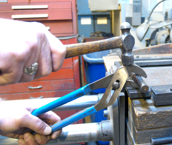

You could just press the bearing on again, but there's a good chance that it will come loose once more. Instead, create some spurs or gauls in the spindle over the area where the bearing is seated. Grasp the spindle in a channel lock pliers, rest the bottom jaw on an anvil, and hammer the upper jaw hard. Turn the spindle 90 degrees in the plier jaws and repeat.
[ATTACH]171[/ATTACH]
Spread a drop of red Locktite over the area of the spindle you have just massacreed. Insert the shaft in the bearing, then press the shaft into the bearing until the shoulder butts against the bearing housing. Replace the spindle-bearing assembly in the quill, install the quill in the headstock, and you should be back in business.

Thanks Nick,
It is really helpfull to see the photos. I like to know what I am getting into before delving. The exploded diagram on the website is small and low resolution and hard to see.
I thought that is what might be the problem.
I will let you know if it doesn't work, but I think it will.
JeffG
JeffG

Problem Resolved.
Nick et al,
Thanks for the help. It worked great and the problem is resolved. I also did the same thing on another machine that the spindle was loose on. It solved that problem too.
Now I am ready for the travelling academy classes next weekend. I can't wait.
JeffG
JeffG
