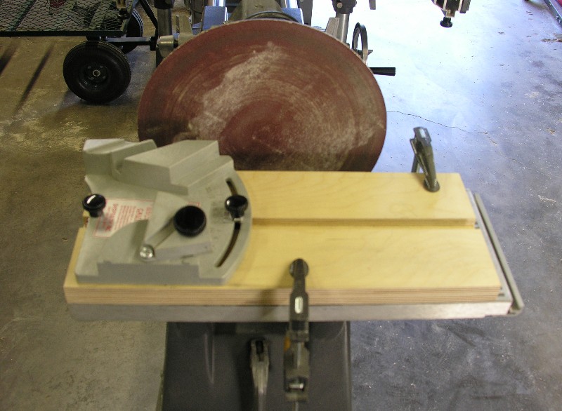

Does anyone have a link to a picture of the SS Sharpening Jig mounted on an extension table? I know I've seen a picture somewhere (but maybe not on this forum). The setup is made by attaching the jig to a piece of plywood and clamping the plywood to the extension table but I can't find a picture.

I use the sharpening jig on a board that I cut a mitre slot in that is clamped to the extension table of the SS. I found that the mitre slot in a board gave me better positioning of the sharpening jig and I just hate to drill holes in my extension table. I will try and post a pic of my setup.

I just bought the sharpening jig. It came with a template for drilling into the extension table for mounting. But, like Idh, I don't think I want to do that. I look forward to Idh's photo.
The other alternate is to mount it on the main table using the left side miter slot. This is how Rick demonstrated the sharpening at the TA I attended in May.

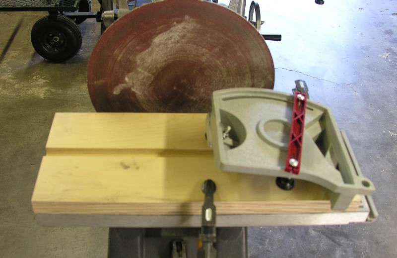

This is the simple jig that I use to attach the SS sharpening attachment to my Mark V. It is made up of three pieces of 1/2" ply glued together to form a mitre slot for the sharpening attachment and then clamped to the extension table. The pics are not real sharp, but frankly I am not real sharp this morning. Hope it helps.

ldh: Thank you for posting your jig. I drilled my table as recommended but it gives me no room for adjustment. Your jig is so simple and allows for infinite adjustment if necessary and is so quick. Having to remove the plastic miter bar and reassemble screws through the table and then still have an immovable object was a real chore. I'm going downstairs right now and build one.

I made one like ldh shows in his pics. I learned about it from Rick Davis at a TA session. I drilled some matching holes in the jig and can also attach it to my saw and jointer fences (although I haven't tried this part yet). The slot works for holding feather boards.
I cut the slot in the jig on the Mark V set up as a router. It took a couple of tries and was good practice but need to be really careful.

I think when I got my sharpening jig SS suggestted mounting it to the plywood instead of directly on to the extension table. I have never used it on the main table with the plastic mitre bar guide.
I mounted mine on a piece of wood that was the same size as an extension table and used the included template to drill the holes to fasten it to the board.
When I grind using the main table I simply clamp the board to the table and grind. When I want to use the left side I clamp the board to the extension table. I usually allow the board to protrude off the table toward the disk to insure that either the main table or extension table doesn't get ground.
I drilled a hole in the board and hang the whole assembly on the wall when not in use.
