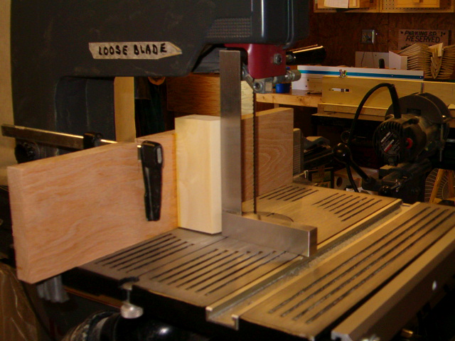

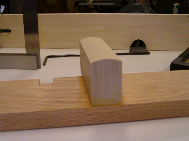

otee453 showed us his - now I'll show mine.
I know the fence adjustment is a much used method, but it doesn't work for me as the blade may drift a little in both directions, depending on the grain. I use a SS 5/8" skip tooth blade.
I draw lines like 8iowa and Dusty described - then clamp the jig to the fence and simply follow the line. Works every time - no adjustments other than depth.
Also many folks use the single point fence, Rockler even sells one. Here's mine:
[ATTACH]3332[/ATTACH]
[ATTACH]3333[/ATTACH]

oops, sorry, I should've noted that the link I provided isn't mine, it was just the first pic I found on a google search.

That's O.K. Otee! Thought that might be the case, but couldn't resist the "show me yours - I'll show mine" thing. BTW, I really like the one you showed.otee453 wrote:oops, sorry, I should've noted that the link I provided isn't mine, it was just the first pic I found on a google search....
...Sorry for the misunderstanding, but I think the idea has been presented.
I genuinely believe these things are Magnitudes easier to use than an off set fence.

Only thing I've found is the face of your material against the "fence" must be good and flat. If it is not, it want to push the material into the blade from the side, causing alot of binding and stress on the blade.
