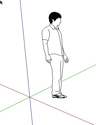

Please pick the Engineering - Feet and start sketchup
The screen opens looking like this
[ATTACH]2476[/ATTACH]

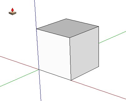

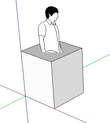

Just to get an idea of the scale of this I make a 3' x 3' x 3' cube and this is what that looks like
[ATTACH]2478[/ATTACH]

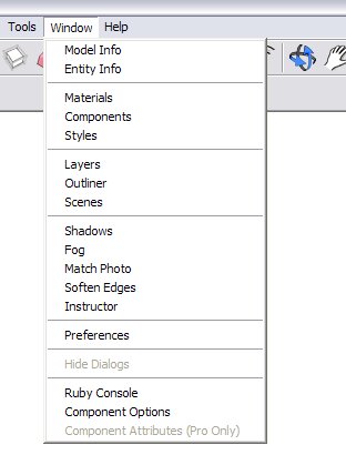

This might be nice for some project but for today we will make some changes. Start by going to the Window Menu and clicking it, you should see something like this
[ATTACH]2477[/ATTACH]

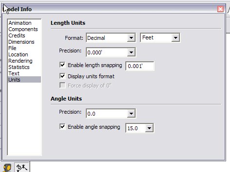

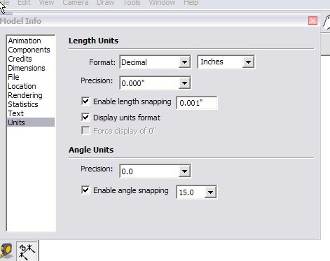

If you now click on the Model Info another window opens that looks like this
[ATTACH]2479[/ATTACH]
Under units we see the format is decimal and feet. We are going to change that from feet to inches...

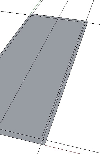

Now zoom in until you have a reasonable size view of it on the screen. Using the push/pull tool pull up on it then type in 1 to make it a 1" x 1" x 1" cube.
[ATTACH]2482[/ATTACH]

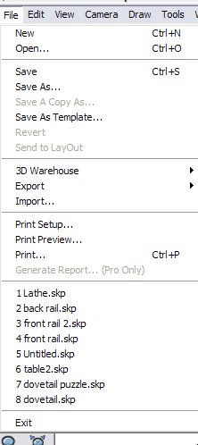

Next we will go to the file menu and it should look like this
[ATTACH]2483[/ATTACH]

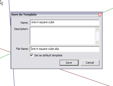

What we are doing is creating a new template, it will need a name and in this example I used "one in square cube" on the real one I did I called it "1 inch block" you can use any name you like. When you click on the file name: it defaults to the name with a .skp extension. It also has a box to set it as your default template... again that is up to you if you want it that way.
[ATTACH]2484[/ATTACH]

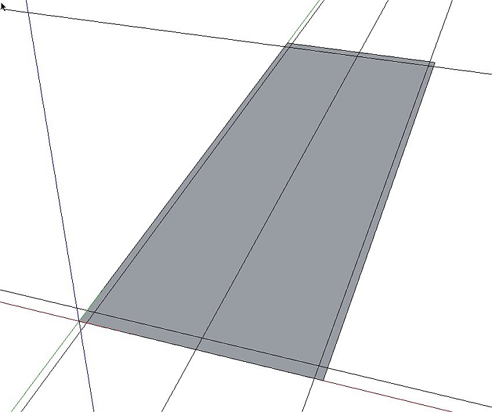

Now about the project we will be working on. Since I already have rails done and a main table the next thing on my list is to do a floating table. I will also be working in decimal numbers so get out your chart/calculator if you want or use another feature of sketchup... for this lets do a little test which will point out two things that should be noted.
Using the rectangle tool make a box and type in 15/16,15/16. Now pull up and type in 15/16. Go to the dimension tool and put some dimensions on the cube. You should see that you have a cube that is .938 on each side. So if you want to enter fractions you can... the second thing to notice is that the dimension is .938 where 15/16 is really .9375. This was because we have the precision set to 3 decimal place, if I were doing a real mechanical drawing I would work in 4 decimal places but for a sketch it is not worth it.
[ATTACH]2486[/ATTACH]
Now we have to come up with some dimensions to use. Again remember this is just a sketch and an example so lets start with saying the table is 7.5" wide and 22" long. To start with you can clear away the cubes you have up and start with a clean screen. Using the rectangle tool make a rectangle and type in 7.7,22. You may have adjust you view but it will look something like this.
[ATTACH]2487[/ATTACH]

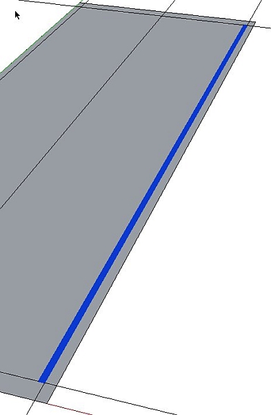

This next part also seem to be a little hard to get use to but we can work through it. We are now going to use the rectangle tool and make a rectangle using the guide lines at the front and the back along with the one on the right side. We want to make a groove but for now we are just doing a rectangle at this location. So go ahead and do that. Remember we want it to be 21" long and .130 wide.... problems??? Yea it works that way, but it is not a real problem, we just need to type in the numbers.
[ATTACH]2490[/ATTACH]
You can look at the lower right of your screen and see that mine came up to 21" x .247". The simple fix is to type in ,.130. you could type in 21,.130 that works too.
[ATTACH]2489[/ATTACH]

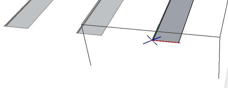

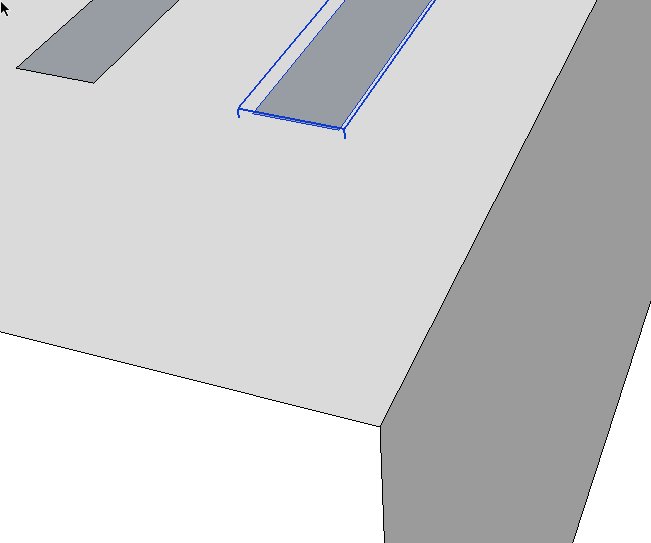

Since I like the look and placement of the grooves I'm going to remove them by doing an Edit, undo array. You will see why I did that in a few moments.
At this point we are going to introduce something that we really need to do with the "groove" we made. The groove is going to be a component. We will go through this now. The "groove" needs to be selected, pulling a box around it works well and you will end up with something like this
[ATTACH]2494[/ATTACH]

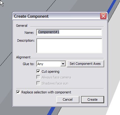

The component can be created by clicking the funny box with light blue around it or by using the right mouse button.
[ATTACH]2495[/ATTACH]
A box will appear on the screen like this
[ATTACH]2496[/ATTACH]

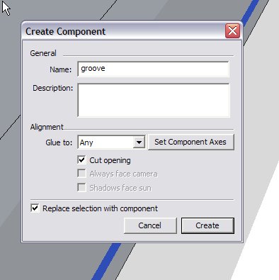

You can fill in the name and leave the rest of the information alone.
[ATTACH]2497[/ATTACH]
The result will be a screen like this

Now we can do the same move operation we did before but this time we are moving a component. Go ahead and make the copies and head to the next post.

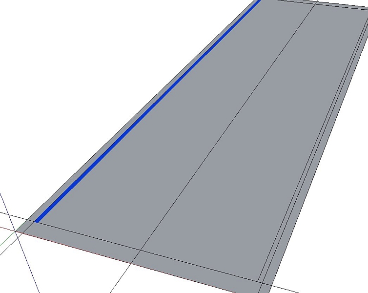

A quick measurement of the thickness of the table gives us about 1-1/2", go ahead and pull the table top up that amount.
[ATTACH]2499[/ATTACH]

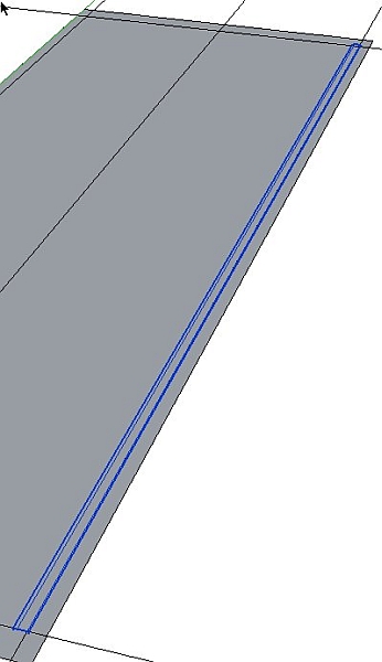

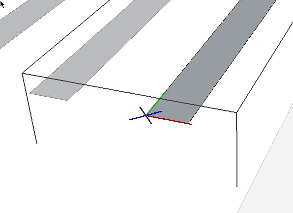

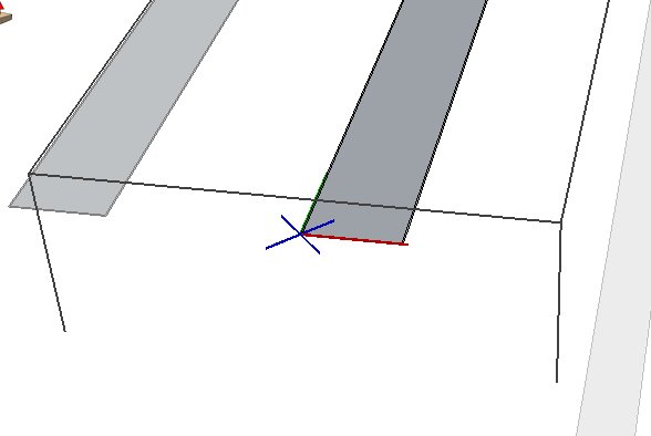

Now we need to zoom in on the upper left corner of the table top. Using the select tool on the "groove" you will see something that looks like this
[ATTACH]2500[/ATTACH]
If you double click again on the "groove" you will now be inside the part and have a screen that looks like this
[ATTACH]2501[/ATTACH]
Now for a bit of magic, if you pick the offset tool and make an off set of the rectangle by say .002 you will have something that looks like this
[ATTACH]2502[/ATTACH]

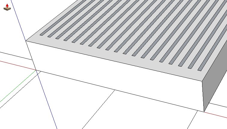

now with the push/pull tool pull down and use the dimension of .01. All of the grooves now have this done to them. It should look like this
[ATTACH]2503[/ATTACH]

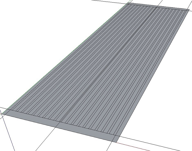

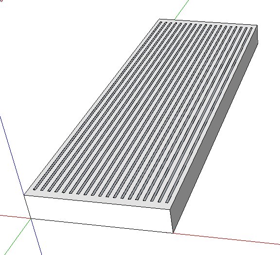

You can now zoom out a bit and have a look at your new table. It should look a lot like this
[ATTACH]2504[/ATTACH]
Keep in mind this is not the only way to do this and I don't want to get you to confused as what was done so at this point questions and comments are welcome.
If someone wants to post a different way that is fine too. Keep in mind this is for us people new to sketchup and you can get way over our heads in no time I'm sure.
Hope you enjoyed this and I hope it was helpful. If you got lost along the way it now time to ask those questions too.
- ScreenHunter_034.jpg (74.55 KiB) Viewed 6617 times
