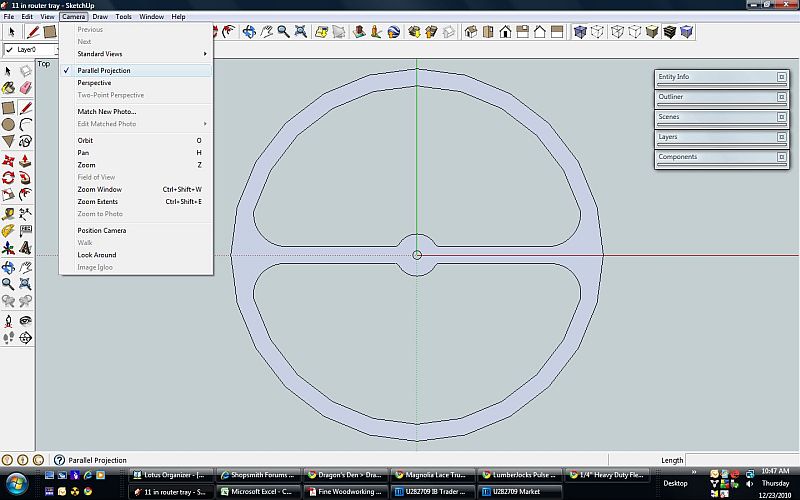

Next go to the Camera drop down in Sketchup and select "Parallel Projection". This should be the only item checked on the menu.

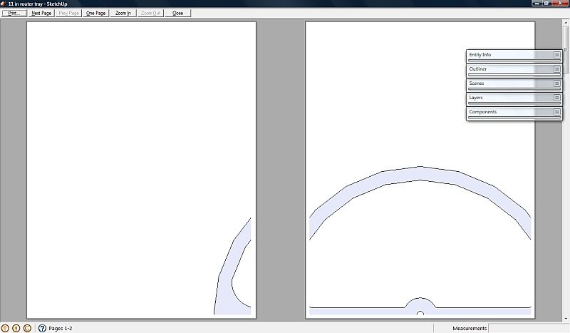

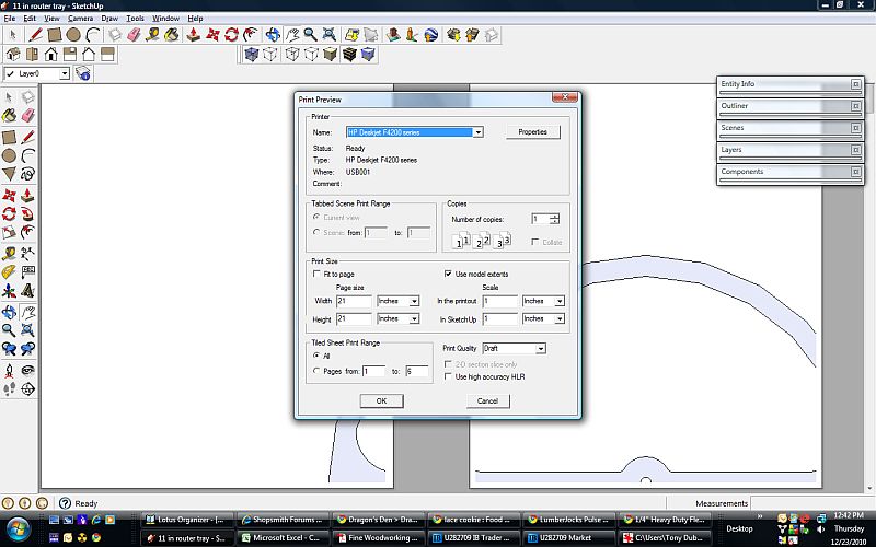

Then you would go to "File" "Print Preview" to open the Print Preview dialog box. In this box you you have to do a couple of things.
In the "Tabbed Scene Print Range" make sure the correct scene is indicated if you have more than one in both the from and to boxes.
In the "Print Size" box make sure that "Fit to page" is not checked. Make sure that "Use model extents" is checked. Make sure the scale "In the printout" and "In sketchup" are both set to "1". Don't mess with the page size as it just indicates the size of the tiled sheet and NOT the paper size. At this point you can click the OK button and preview your printout. If everything looks good hit the print button and you are set.
[ATTACH]11240[/ATTACH]
Parallel Prospective.jpg (58.16 KiB) Viewed 1710 times

Print preview.jpg (63.28 KiB) Viewed 1673 times
