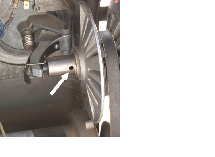

my speed control is getting hard to turn. seams like there is dust(dirt) inside. is there isntructions on how to ceal it somewhere? new to this machine mark v thanks larry h
Sounds like you need some old-fashioned lubrication. First run the speed up to as high as it will go, turn of the machine, and unplug the Shopsmith. Remove the rear cover, spread the spring on the bottom shaft with a blade screwdriver until you see the hole in the bottom floating sheave bushing. (See below.) Place 2 to 3 drops of light-weight machine oil in the hole. [ATTACH]144[/ATTACH]
Remove the Shopsmith logo medallion from the side of the headstock opposite the switch and find the hole in the bushing for the upper floating sheave. (See below once again.) Place 5 to 6 drops in this hole.

After oiling the sheaves, reassemble the headstock, turn on the machine, and run the speed changer up and down its range several times to spread the oil over the shaft and bushing surfaces.
99 times out of 100, this will fix the problem. But if the speed changer is still difficult to turn, it could be that you haven't cleaned out the inside of the headstock for a while. Remove the medallion and the rear cover and suck (don't blow) out the fine sawdust. (If you blow out the sawdust, some will find its way inside the motor where it won't do anyone any good.) Should you have to disassemble the speed changer to get at all the ackempunky that sometimes accumulates in the ring gear and other parts, suggest you check out this thread: https://forum.shopsmith.com/viewtopic.php?t=144.
