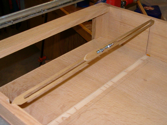

Many of you have already found that the use of story sticks is not only easier than using a measuring tape, but more accurate.
I made three adjustable story sticks some time ago (each different lengths) and this is a photo of using the smallest one to measure and to cut the pieces that will fit into the dadoes. Just adjust the length with the two bolts/wingnuts. Also use this stick between the saw blade and a stop block for the accurate cut.
The most popular use of these pointed sliding sticks is to determine the squareness of a frame.

Great idea.
Could you post more pics? These old eyes:( and slow brain cannot determine just how ments are made are made.
Thanks.

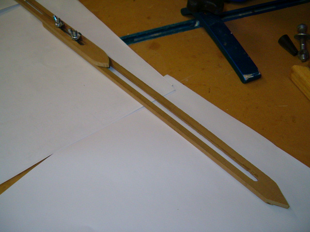

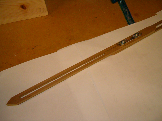

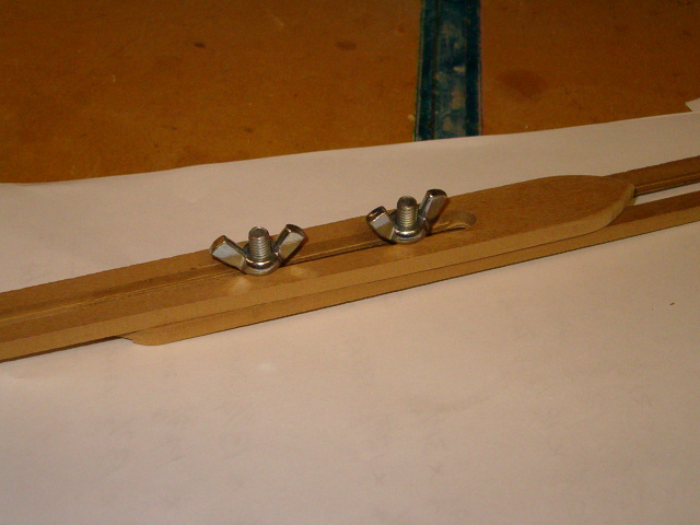

O.K. a couple more pix will be coming -
To make a couple of these - get some scrap stock- (I used ¼" MDF).
--Using a wider piece of scrap for safety's sake, Route a ¼" wide slot in the scrap, about a half inch from the side.
--Then saw closer to the slot on both sides and cut points on the ends.
I used a band saw to make the sides of the scrap closer to the sides and to make the points. (the points don't have to be perfectly centered - just free handed.
These sticks will reach exactly into corners or into smaller slots or dadoes.
With Several sizes of these sticks there is no longer a need to bend a measuring tape, "loose an inch" on the tape, or make an approximate pencil mark on a stick. The sticks are held together only by the small bolts and matching wing nuts. You can have a 6 inch stick, 1 foot stick, a 2 ft. stick a 3 footer and so forth. They can be mixed and matched to fit your needs.

Thanks for sharing the pictures of your story sticks. I have used story sticks in the past but never gave any thought to making an adjustable one that I can reuse on another project. Usually if I had a stick with any length I would save it for a future project and if I needed a shorter one then I would cut it down to desired length. I definitely like your method and thinking. That's what is so good about this forum. Always learning new and good ideas to make woodworking more enjoyable and saving on unnecessary expenses. Thumbs Up!!
