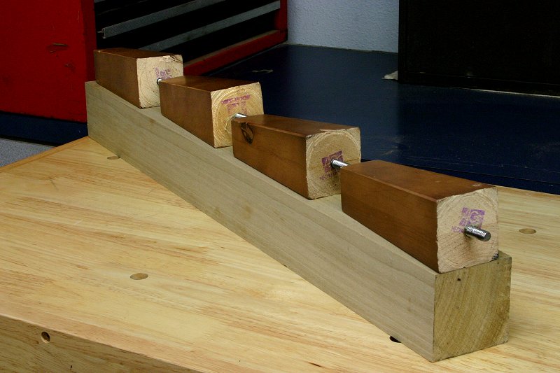

Committed to have a project done by the end of the weekend. I have to turn this piece of 3" x 3" x 30" poplar into 4 tapered furniture legs, identical to the ones shown.
[ATTACH]9725[/ATTACH]

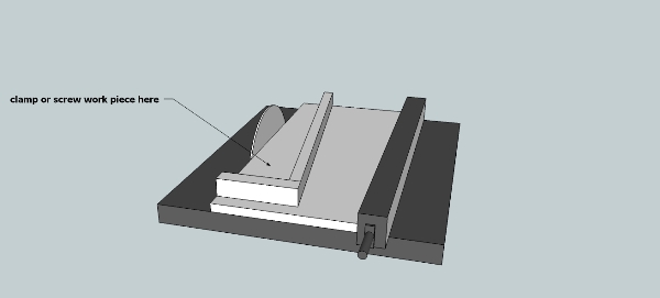

  2. Can I stage the individual cut lengths as shown below? (I'd have the piece clamped to the miter gage extension, cutting widest to narrowest)
  3. Is the method shown below safe?
[ATTACH]9727[/ATTACH]

I'll defer to someone more knowledgeable and experience than me, but I would think a tapering jig would be better (safer and more reliable) than using the miter gauge in this instance.

That second pix is a BAD idea.
