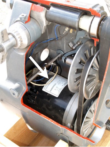

With all the talk about higher horsepower motors, I'm anxious to know what I've got. How do I tell?

Hal, remove the Shopsmith medalion thingy from the side of the headstock opposite the speed dial. Peer inside and look down -- the motor is in the bottom of the headstock. The label should be turned up and the horsepower information is on that label. But just to make your search fun and exciting, it's on the portion of the label that curves away from you and it's printed fairly small. You will need a flashlight, the eyes of an eagle, and the patience of a saint. Fiber optics are optional, but handy.
[ATTACH]44[/ATTACH]
There's an easier way, but it's not as certain. The 1-1/8 HP motor was introduced in 1962; Shopsmiths manufactured prior to that date had 3/4 HP motors. Check the serial number of your machine. If it's a six-digit number 373422 or less and the headstock is painted a color other than gray, it was made before January 1962.

- Motor Label.jpg (50.26 KiB) Viewed 32271 times

Paul, I'm told that we looked into higher horsepower motor many years ago, but found that at the speed the motor must run (1725 rpm), higher horsepower would require more windings and therefore a large motor. It's pretty cramped in the motor pan as it is, so we never pursued the matter. A horswe and an eighth seems to be adequate for all the woodworking operations that the Shopsmith is designed to perform, and the longetivity of these motors even in environments like schools where they are used almost daily would seem to bear this out.
