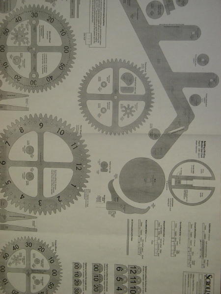

The plans are from ScrollSaw Woodworking & Crafts Issue 42.
[ATTACH]22644[/ATTACH]
After making copies of the plan I cut up the plan according to stock thickness and type. There is 1/8, 1/4, 3/8, and 1/2 plywood and well as 1/8 and 1/2 hardwood. In the past I’ve had issues applying patterns to wood. Either they come loose while cutting or fray so lines can’t be distinguished and/or are difficult to remove. So after checking with a couple of folks on another forum I decided to try covering the face of each piece of stock with ‘blue painters tape’, adding the pattern with 3M adhesive and then covering the whole thing – front and back with packing tape. This seems to work pretty well but I’m not thrilled.

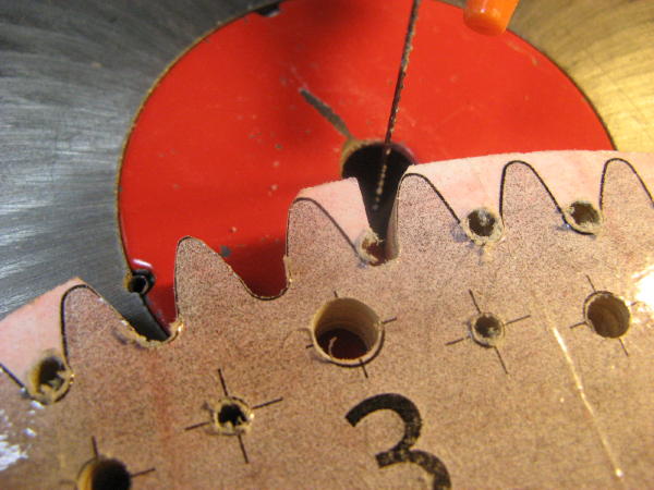

A pic of the scroll saw action. I've replaced the insert with a shop made ZCI.

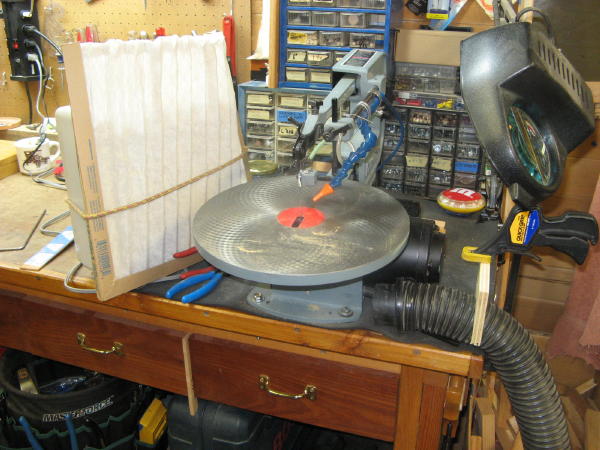

And here's a view of the scroll saw and the first class dust collection system.
[ATTACH]22649[/ATTACH]

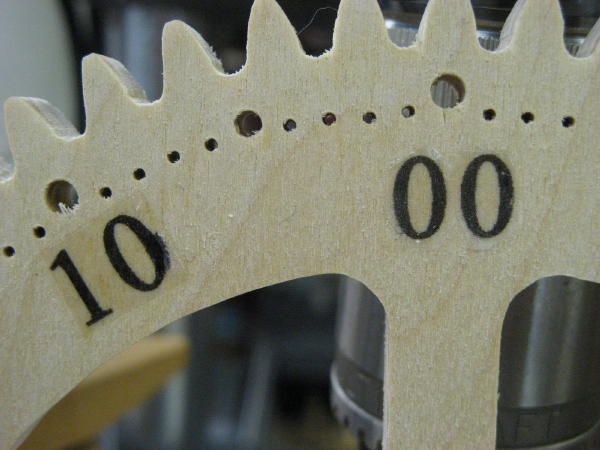

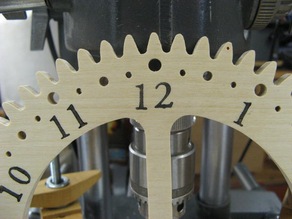

Jeez this project is taking forever. (Well I did have that nice two week trip around Lake Superior and it is that time of year that I have to rake the endless supply of leaves I collect each autumn. And I've been trying to help my kid repair his 95 Honda after it was stolen.)
But you interested in the project. So I really struggled with how to add the numbers to the face. I ended up purchasing a set of rubber stamps (Garamond type) and added the numbers to the largest face. I made a little jig that helped my position them and used acrlyic paint.
[ATTACH]23249[/ATTACH]
When I went to add numbers to the other face my stamps were too large. Agh! So after some trials I ended up using the computer to set the numbers I needed, reversing them with Paint, printing them out onto Jolee's Easy Image a product used to transfer computer art to fabric. But it seems to work okay on wood.
[ATTACH]23250[/ATTACH]

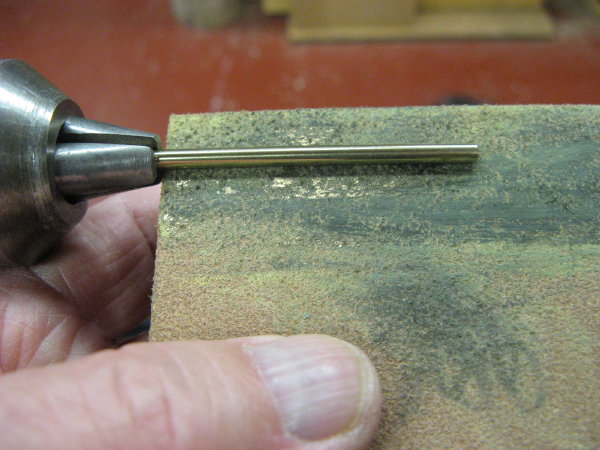

The instructions called for polishing the brass shafts (1/16”, 1/8”, and 1/4”) that the gears rotate on. I mounted the shafts in the drill press, carefully tightened the chuck so as not to ‘ding’ the shafts, and turned on the SS at the lowest speed and polished each shaft. Turned them end for end to do the other halves.

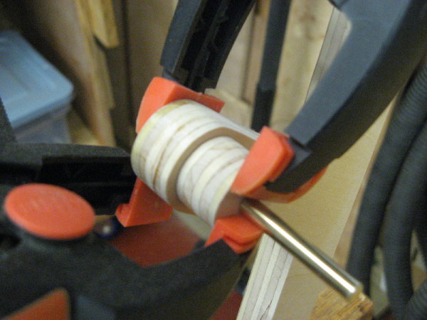

Next these had to be mounted on the base. The shafts seemed loose so I applied a couple drops of CA glue to each so they are fixed to the base. The shafts have supports that are glued to the base. I used a waxed shaft to ensure the pieces didn’t move during glue-up.

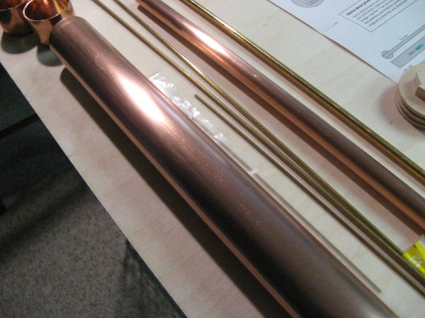

Copper pipes are used for the weights. As you’d expect the copper was pretty oxidized. I cleaned all the copper in a roasting pan (jeeze don’t tell my wife PLEASE). I used 1.5 cups of vinegar and tablespoon of salt and the hottest water I could get from the tap. I let it soak about an hour and then brushed it with “0” steel wool.

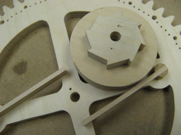

Even though I made the clicker (ratchet assembly) exactly as in the drawing they were too large for the clock. I had to re-cut those parts.
[ATTACH]23583[/ATTACH]
I also discovered a couple parts were miss-labeled between the directions and plans. Finally, there was no dimension for the length of the pendulum shaft But I got it all sorted.
