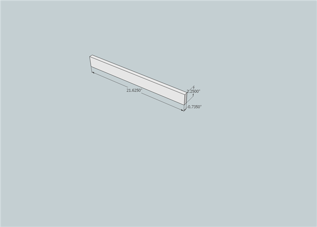

I've made one that I use for rip fence alignment.
It fits tight in the miter slot and stands proud of the table top about 2". When I want to check of align the rip fence, I just insert this into the miter slot, Slide the fence up to it and check the gap. If I want/need to align the fence, I loosen the screws, slide the fence up against the jig, clamp it there (infeed end first), tighten the screws and go make saw dust.
