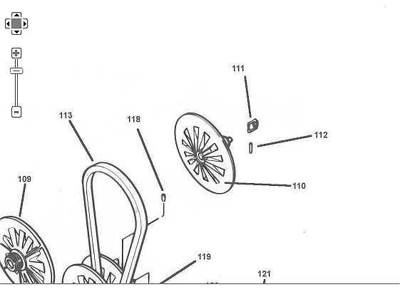

Well, I fixed all that. The Fan Sheave (#504207) had moved, and was scraping against the Fan Plate (#504206). Easy fix.
However I had to nearly take the entire thing apart, before I found the Retaining Loop (#504187) was missing. [Incidentally, it is also missing from any exploded view drawing available.]

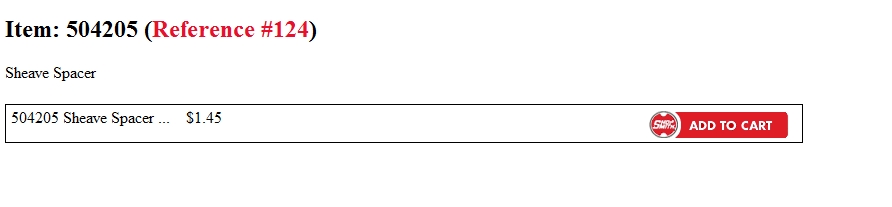

With the belt back on, can ya isolate the noise? I'd still suspect the fan sheave. Do you have this installed? Item#124 part number 504205 Sheave Spacer? Do you lube the SS about every 10 hours?

FWIW, a common 'problem' is the spacer behind the fan sheave becomes embedded into the fan sheave hub and the fan sheave scrapes against the end of the motor.

Part 111 is the Retaining Loop (504187). I use either a steel .020", .030" or .040" flat round 5/8" ID shim againest any Floating Sheave that the sheave spacer has embedded into. I find the sheave spacer lengths are between .380" to .410" so I machine new spacers for a .430" length. I go for at least 1/16" to 1/8" clearance between the fan sheave and the motor plate.

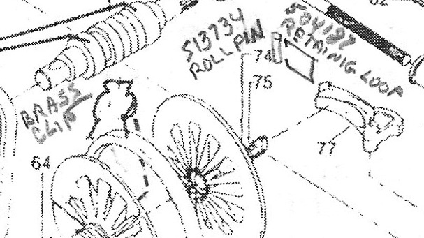

I have an older manual, with poorly reproduced exploded drawings. #111 isn't the best representation of the Retaining Loop. A quick pencil sketch is:

Ah so! The clip that 'retains' the idler sheave on the shaft.
A pita to remove. Only there to prevent the idler shaft from moving towards the end of the shaft when no belt is pressing it against its stop.
Part of 'our' confusion, is that there are two retaining loops. The hair pin one you just sketched and the more prominent more widely known speed control loop on the end of the control sheave(that be the square shaped one).
As for the sleeve, first determine if you still have one. If so the fix I mentioned or Bill's fix should fix the noise.

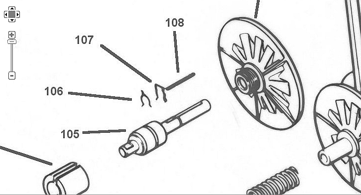

So, next step, Remove the orbit launching spring, remove the fan sheave and look fer de sleeve and non-original groove in the sheave hub.
FYI "107"
The "sleeve" is:
