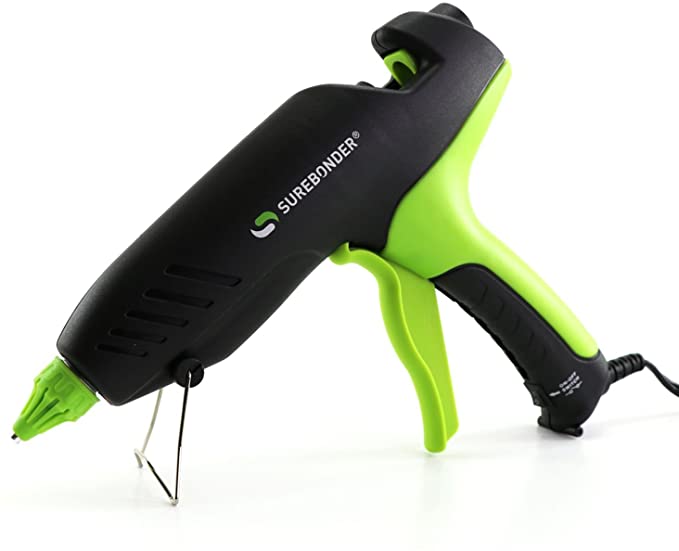

My wife has a hot glue gun as well, but I bought my own. It’s MUCH bigger than hers. :cool: :D
If you’re working on a fairly large board, a high-capacity heat gun actually is a good idea. The one above costs $36 at Amazon.
Assuming that you have a flat surface (very important) on which to assemble the sled “sandwich”, there’s no need for the sled base to be terribly rigid. What happens is that the entire assembly winds up being a torsion box, and is thus inherently very rigid. The sled base is the bottom skin, the workpiece is the top skin, and the hot glue serves as the webbing. I like to use a 12” wide melamine-covered particle-board shelf (from the big box store) as the sled base. The masking tape sticks to the melamine well enough, but it’s still reasonably easy to pop it off of the melamine surface when you’re fnished flattening.
