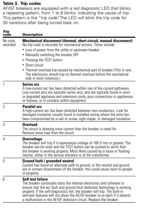

A follow-up, because I found this surprising. I was looking at a combined AFI/GFI Circuit Breaker at HD because current NEC has those as combined requirements for some circuits: https://www.homedepot.com/p/Eaton-CH-15 ... /311720932 The amazing part, other than price, is this: "Built-in LED indicates seven trip causes" SEVEN! Overcurrent, Arc Fault, Ground Fault, and four more? I hope it comes with an owner's manual. And a home wiring diagram. Coming soon, no doubt, in increasingly wide-spread use. (The rental house I'm looking at buying currently has two Eaton CBs that combine current with arc and ground faults, though I don't know if it is this specific model.)
- David
- David
Re: GFCI protected circuits
David,DLB wrote: Wed Apr 28, 2021 2:36 pm A follow-up, because I found this surprising. I was looking at a combined AFI/GFI Circuit Breaker at HD because current NEC has those as combined requirements for some circuits: https://www.homedepot.com/p/Eaton-CH-15 ... /311720932 The amazing part, other than price, is this: "Built-in LED indicates seven trip causes" SEVEN! Overcurrent, Arc Fault, Ground Fault, and four more? I hope it comes with an owner's manual. And a home wiring diagram. Coming soon, no doubt, in increasingly wide-spread use. (The rental house I'm looking at buying currently has two Eaton CBs that combine current with arc and ground faults, though I don't know if it is this specific model.)
- David
This might give you some insight into the other codes. This is a different AF/GF breaker product from Eaton, but probably has similar LED codes to the one you found.
