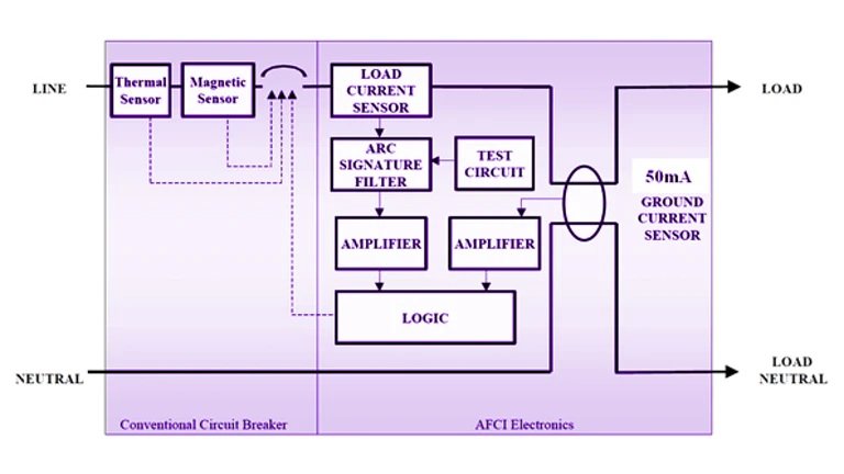

So, I dug up some more AFCI information that I think sheds more light on how they function and why a PowerPro might trip one. Below is the block diagram for what is happening in an AFCI. In the excerpt from this below you can see that the key point of how "bad" arcs are determined by an AFCI is by looking at whether the waveform is periodic or not. So, a well behaved brushed motor might be seen as a "good" arc, but asynchronous switching waveforms backfed into the supply line from a PowerPro could be perceived as a "bad" arc. Also spurious harmonics (from a PowerPro) being fed back could also trip the "bad" arc signature circuitry, I suspect.
Except from paper linked below:
A major design consideration was the ability of the AFCI to discriminate between “good” and “bad” arcs. “Good” arcs are characterized by being periodic or repetitive (occur each 60 Hz cycle) and can be non-sinusoidal. “Bad” arcs are characterized by non-periodic or non-repetitive waveforms.
AFCIs use electronic detection circuits to discriminate between good and bad arcing conditions. Once an unwanted arcing condition is detected, the control circuitry in the AFCI trips the internal contacts, thus de-energizing the circuit and reducing the potential for a fire to occur. Methods for the detection of “bad” arcs include looking at certain frequencies, discontinuities, and inconsistencies in the current waveform. For detection, both magnitude and duration of a particular half cycle are required. Some detection algorithms also look at rising or falling edges of an arcing current for their detection criteria. The industry voluntary standard for AFCIs requires a trip if 8 half cycles of arcing occur within a 0.5 second window.
