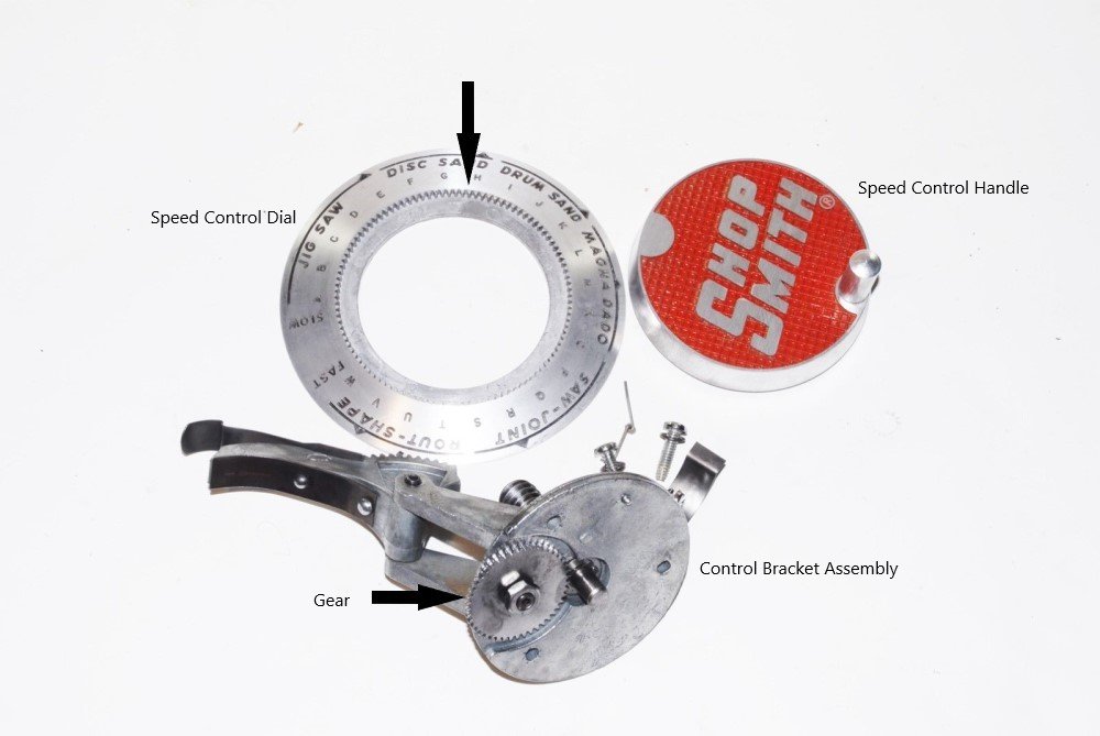

To start off, hopefully you have a manual for your Mark 5. That being said if it is the original Owner's Guide from 1955 it is not as much help as a more current one which hopefully you have from the 510 upgrade. The Speed Dial can be turned past fast if the High-Speed stop is not adjusted correctly. There have been instructions available for setting the High-Speed stop but unfortunately I don't have a PDF copy and cannot locate it here on the new Shopsmith Website. Someone else may have a PDF copy available and post. Later Manuals have those instructions. The adjustment is made by loosening the lock nut on the Set Screw at the center of the gear shown in the picture of the Speed Control parts below. That set screw limits the inward travel of the Quadrant and therefor the high end of the speed range.

The System will still run without the Speed Control Assembly in place. I do NOT recommend running it without the Speed Control Assembly in place as there isn't anything to hold the moving Idler Shaft Pulley Sheeve in position.
As for the speeds seaming to be "off" the Motor to Ilder Shaft Assembly V belt could be the cause. An old worn V belt or even a new V belt that is not the original size will cause the speed to be "off" from what they should be. Use of a tachometer will help with diagnosing this problem.
