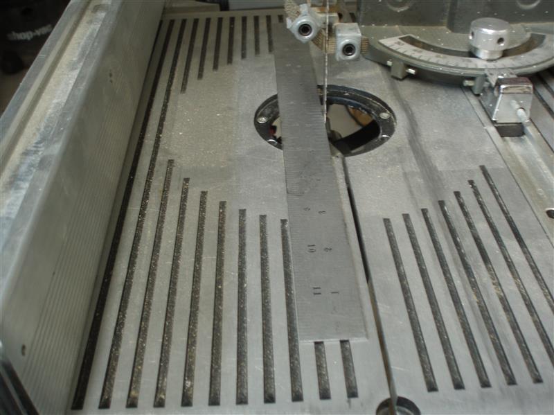

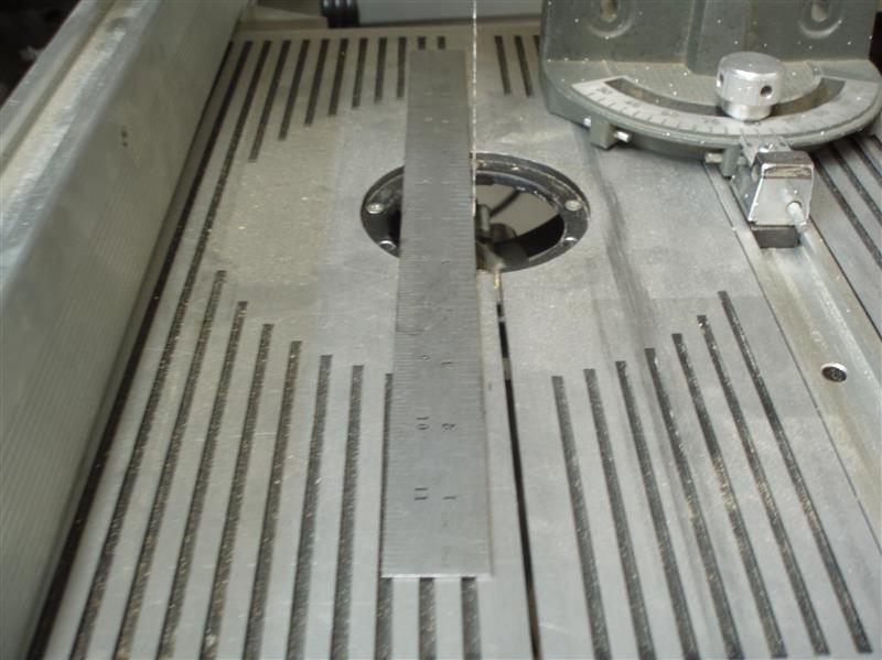

Three degrees is not very much so I may have the same twist and have never noticed it. Remember, the cool blocks are there for a purpose and maybe this is it. This could also be the reason why you lower the guides down close to the work. When set up properly for a cut, there is very little separation between upper and lower cool blocks.
Hmmm. Ya think?
I really don't think I have that sort of twist with the 5/8" blade but I'll look.
The following show my "twist" when not tensioned and then when tensioned. Alignment is different as indicated by the grooves in the table. But I can change that by moving the table. I'm going to leave it alone for now.
[ATTACH]20648[/ATTACH]
No blade tension at all.
[ATTACH]20649[/ATTACH]
Blade fully tensioned.
twist 007 (Custom).JPG (64.95 KiB) Viewed 6283 times
twist 009 (Custom).JPG (68.08 KiB) Viewed 6282 times
